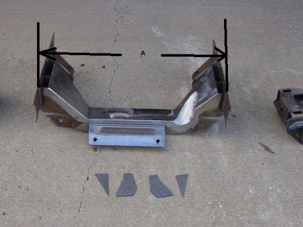

Got this Dakota crossmember on the way from a gent on the HAMB board:
"Hi Greg,
I have the dimensions you requested. As you probably know, the Ford F-100 frame rails taper, narrower toward the fron, therefore the side or boxing plates also taper as to their spacing.
Note: all dimensions below are outside to outside
Using your photo, dimension line "A", at the specific point, where the leading edge of the crossmember attaches to the side plate, the width is 29 9/16"
At the leading (front) edge of the boxing plate the width is 29 3/8"
At the rear edge of the center crossmember to side plate the width is 29 7/8"
At the back edge of the boxing plate the width is 30 1/8"
The overall length of the side plate, tip to tip at the top is 21 9/16"
So, there is 3/4" taper of the side plates over their length
Ray"
With the dimensions you gave me, I think I can squeaze it in with vaseline. Well, I've got $350 into it.... We'll see...

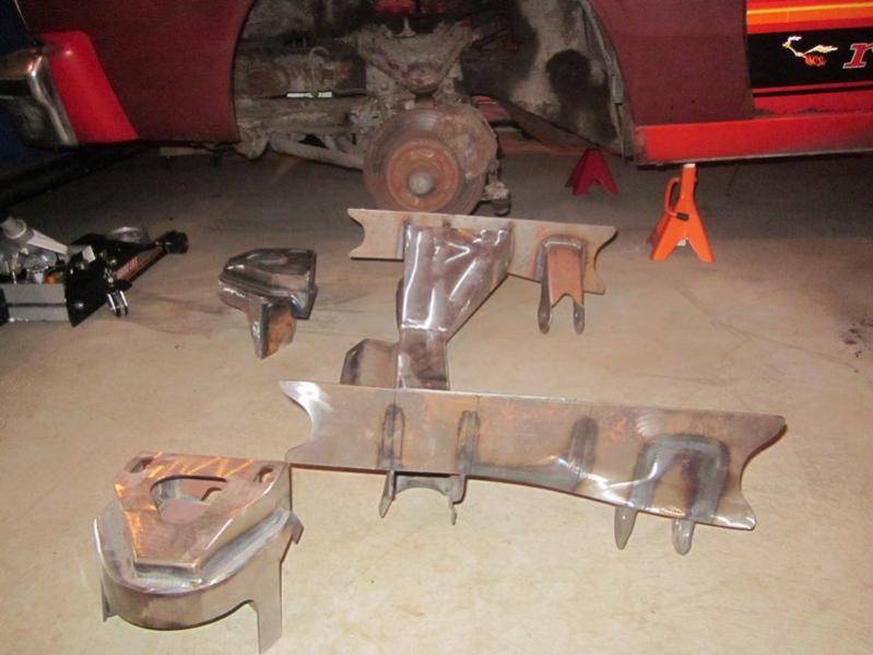

Well, got the crossmember home. I'll take a hard look at proceding....
Greg
No coilovers. Rack and pinion though. This particular crossmember uses all stock Dakota parts. So coil springs, a-arms, spindles will be refurbished boneyard. Elpolako from Industrial Chassis (who built this model) says to wrap the Volare “frame” with heavy gauge steel, and it should be good to go. I’ll also have the frame tied for support. That’s the plan (idea) anyway.
Greg
Well, I've got another 700 bucks into this project. Putting my money where my mouth is....
