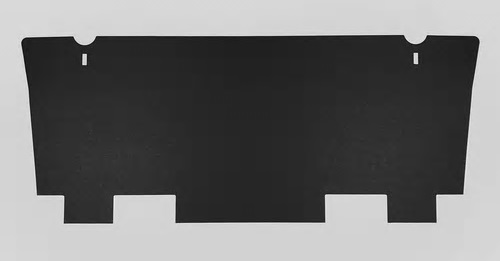

There will be a thick piece of sound deadening material sheet just between the seat called the trunk divider. Don’t get too rough with it for it will tear. This piece of material reduces a ton of road noise into car and is hard to believe it eliminates as much noise as it does. Raise the trunk divider up a short distance to clear the two hooks (red circles, below).

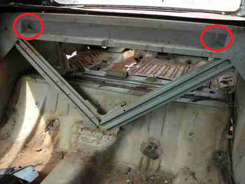

This is a shot from a ’68 Charger – but most FMJ’s will look similar.
A SMALL person can craw though the hole – but the other 95% of us, there ain’t no way that will happen.

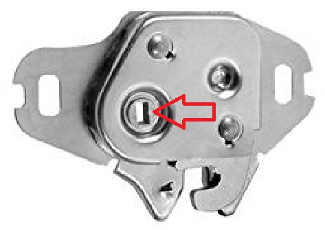

I have a four-foot long flat blade screwdriver just for the purpose of opening trunks like this. Once you get the trunk divider panel removed, it helps to get a flashlight (or two) or a helper to hold a flashlight. On the rear trunk panel, there will be a silver trunk latch.
On the latch there will be an area looking like this:
Insert a screwdriver into the slot indicated and twist (counterclockwise). The trunk will open without too much effort.
If it has been a while sense trunk has been opened, then it might be a good idea to have a helper open the trunk for sometimes the weatherstripping will hold the lid closed.

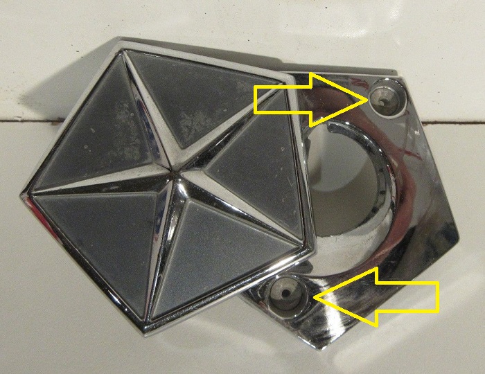

The difficulty will be is if your car has a cover for the trunk lock like this:
If so, you will need to drill out the pop-rivets out (yellow arrows, above) to get the medallion removed before the lock cylinder can be removed. It is not too hard a job to do. I can’t remember if rivets are 1/4” or 3/16”. The lock cylinder pulls right out. You “can” travel with lock cylinder removed. To open the trunk, just insert a flat screwdriver into the “missing” lock cylinder hole and turn clockwise. With that said, EVERYONE else can open your trunk, as well.
I hope this helps.
