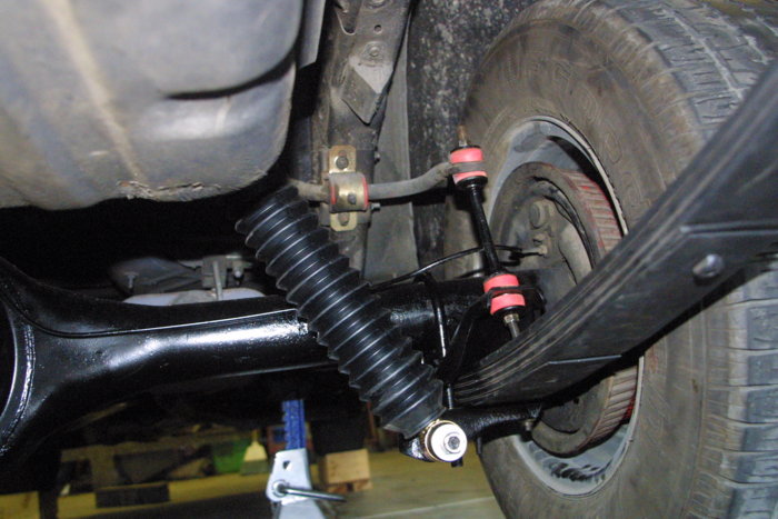

I wasn't aware the leaf spring shackles were different between the civi and fleet models. The cop rear sway bar I bought bolted right in with the correct shock plates. Eventually I got rid of the ISO setup by using some plates from Firm Feel to replace the factory shock plate in conjunction with B body shock plates. Worked nicely. Was able to top it off with Edelbrock IAS shocks - bought them right before they ended production.

There is one minor difference – but to many this is a benefit, from getting rid of the Iso-clamp system . . . the rear car height is raised roughly ½” higher.
The differential stays at the same height - sense it is fixed via tires/wheels (unless tire diameter changes. at same time).
The rear leaf spring attaches to bottom side of rear differential.
By getting rid of the roughly ½” think rubber biscuit, means the leaf spring now sits ½” closer to bottom side of differential – which also means the bottom side of leaf soring is now roughly ½” father away from the pavement.
