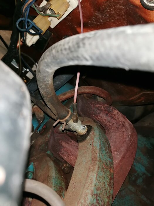

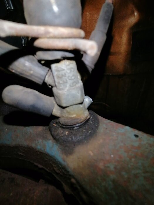

Next thing: The vacuum tee at the intake manifold was really worn out and broke when I removed one plug to connect my gauge... -.-"
Do you know where to find a replacement for the tee? (see the pictures) It doesn't need to be original... a suitable functioning port would make me happy.
All in all the vacuum only reaches about 15 psi in idle and does not hold the vacuum evenly. The needle is "dancing"...

I have an original intake vacuum tree fitting I won’t be using again. You can have it for the flat rate shipping charges at USPS if you like.
69-
Dec 13, 2020
486
343
Germany
Heh, we should have combined shipping to Hannover :)
As an easy fix, plug that brocken port with liquid metal, and use a T adapter in one of the other lines, if needed.

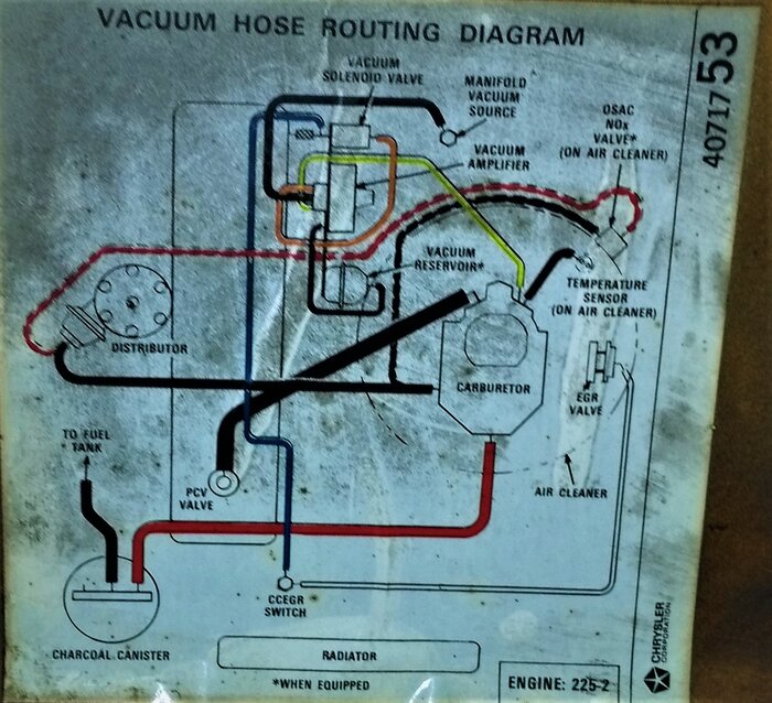

Is this the one on the distributor? If yes, it depends where you are checking from. >The Vacuum advance can itself should NOT leak vacuum, If it does, then it is worthless. But if you're pulling vacuum at the OSAC, that could be normal.
>The vacuum amplifier is a pneumatic relay. The yellow line is the signal generator. The manifold vacuum is the power supply. The orange hose sends manifold vacuum to the EGR,down the blue then white-traced hoses. But it is interrupted twice; first at the vacuum solenoid valve and second at the CCEGR thermo-vacuum valve. This means that three conditions have to be met to trigger the EGR;
1) the carb has to be opened far enough to open the port, and
2) the solenoid has to be energized (usually in Top gear), and
3) the coolant has to be above a certain minimum operating temperature.(usually 195*F)
To witness your system working, you will have to plumb a vacuum gauge close to the EGR valve in such a manner as you can see it from the driver's seat; then with the engine warm enough to open the factory rated thermostat, take it for a hiway run. When all three conditions are met, the EGR valve will open, and if it happens after say 30mph, you should not even notice it.
Your engine does neither need nor want EGR, but there is no harm in running it if your system is functioning properly.
The charcoal canister in the diagram is a full-time running device, but probably gets it's signal from venturi vacuum, or a port above the throttle blades, so that it does Not operate at idle.
I feel that your vacuum could be a little higher. Besides a vacuum leak, the biggest contributors to low vacuum, in order of probability, are;
1) a vacuum leak at one of the ports, or a exhaust getting into the intake underneath the carb
2) a high idle,
3) tight valves,
4) retarded timing,
5) very low or uneven compression pressure
6) a very high "wet" fuel level
The ones most likely to cause; "Idling is not really nice like the engine does not run "round"", are numbers 6,3 and 5, and on a 2bbl; imbalanced mixture screw adjustment. As you may notice, 5 and 3 are related
A wandering vacuum needle is usually showing an AirFuelRatio problem. Thus having a low Vacuum AND wandering needle, that does not clear up with mixture screw adjustment, AND does Not "round out", is usually pointing to a vacuum leak. And since slantys are known for the occasional intake to be leaking at one or more ports at the cylinder head; I would start by looking there.
And then, if you have a Solid Lifter engine, I would definitely go there next; followed by a compression test.
Good luck.

So @AJ/FormS let me answer to your awesome list:
Yes, like I wrote above the advance leaked vauum. At my car the OSAC is equipped but it was not activated. The vacuum from the carburetor directly goes to the distributor. I guess a previous owner canceled the hoses... I am not really interested in causing more problems by re-install it :D... It should not be a problem I guess.
Like I wrote aboce the amplifier won't hold a vacuum when I suck vacuum with my pump (through the black hose at the picture). Thank you for this detailed explanation. It is quite "hard" for a non-native speaker to comprehend all the terms. Your text was pretty much on point and helped me to understand other information from different websites.
The carb is now a restored one. Maybe I change the EGR-valve next. I don't know if the one installed is maybe not completely closed. I "killed" the EGR-vacuum system right now, so it won't open up. But right now the engine runs pretty smooth. Not perfect, but the main issues are gone.
2) a high idle,
The new carb runs pretty slow and it sounds pretty smooth.
3) tight valves,
That is an open to do. When I have more time I will check the whole stuff around the valve cover.
4) retarded timing,
As I wrote in this post: There is no timing scale installed on this engine. Pretty messed up, in my opinion. But it runs fine now and the timing is not too bad. When I have more time, I will manually check the timing by looking for the UDC.
I will test the compression in the next steps also.
The new carb helped a lot I guess. When I find the time I will visit a garage and ask to check with an exhaust probe (Sorry if this term is mistaken).
That sounds pretty plausible and understandable to me. I will check those issues next.
The intake looks tight. No increase in RPM was observed when sprayed with brake cleaner. Since the vacuum looks pretty stable now, I suppose this chalice could pass me by. I really hope so.
Yes sir! I will check those parts next time.
Never thought of valve adjustment if it's solid lifter. Going by your avatar photo, I'd guess it is solid. Too loose or too tight can cause all sorts of problems, especially the too tight way. That can keep the valves from fully closing when warm. Even if it isn't causing any obvious problems, it's always surprising how much smoother the engine runs when the adjustment is correct,,,,,,,and almost more importantly, the same for each cylinder.
Thank you for this advise! I will take a look.

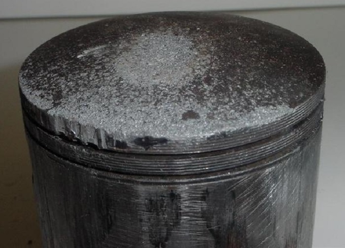

Every time you hear a "ping" or a clatter noise, it is from an secondary ignition flame front (igniting before spark plug does) and the effect to engine is the same as taking a hammer and hitting the aluminum piston top. This happens each and every time a ping or clatter noise occurs.
If you keep hitting something long enough with a hammer, something will eventually break.
Examples:
Each pit is one ping

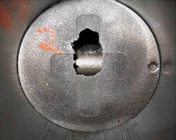

Keep it going long enough and this happens:

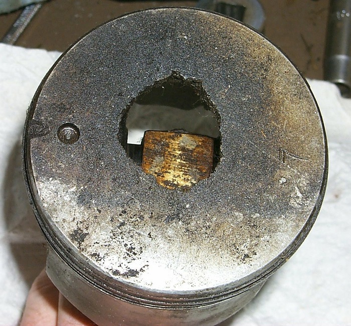

This piston is still in the cylinder.

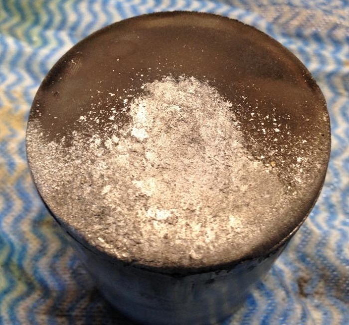

The same kind of damage can occur to aluminum cylinder heads (which not not an issue on stock FMJ's)
