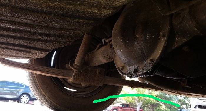

Looking around I came across this photo from an old thread, and it has me wondering if my springs are actually sagged, or if they just always look like this, and I'm just unfamiliar? The front segment on mine has a bit of negative arch ( like the green line I drew) and it appears this one does too. Is that normal? Sorry if I sound like a total noob here, I'm just more used to leaf springs on trucks/jeeps than cars

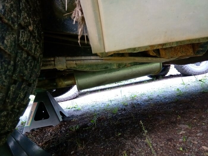

Correct me if I'm wrong, but I'm fairly sure my springs shouldn't look like this :eek:

They can look like that near the perch. They best way to tell is by how the rear end sits really. If it's sagging too low and hitting hard over the speed bumps, it's time.

To be honest I haven't really driven it much yet. still waiting for NY DMV to get back to some kind of normal schedule so I can register it (they're appointment only and booked a month and a half out). When the previous owner had it, it used to hit the bump stops constantly, although that was with his wife and 4 teenage kids in the car
Um, no.
When detached from car, the spring should have a bow shape to it (like bow & arrow, less the arrow). On the car, it might be closer to being straight. Yours looks like mine and have sagged to resemble a "S" now.
If I'm seeing your picture correctly, it appears you have 5-leaf springs on your car. Before taking springs to a spring shop for re-acching, or before ordering new springs - price it both ways first. The result might surprise you (...maybe).
