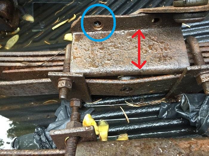

Edit: If you are changing the leaf spring count (increasing the thickness of the leaf spring at the center bolt location), then you will also need to change the lower ISO spring clamp.
The lower ISO spring clamp come in 4-leaf and 5-leaf versions (red arrow, below).
Personally, I recommend getting rid of the ISO-clamp system and replace with the older style shock plate – for your car ride will be SO MUCH improved.
This might be a requirement for some of you – for the 5-leaf lower clamp(s) is not easy to find.
Also, the lower clamp is prong to breakage (blue circle) – leaving your car stuck where it broke at.
Note: someone added an ill-fitting "add-a-spring", in this case.

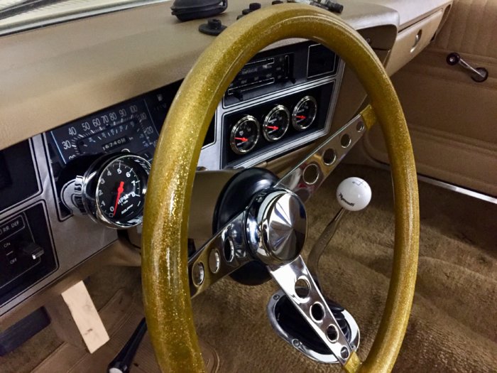

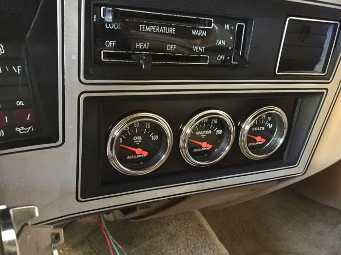

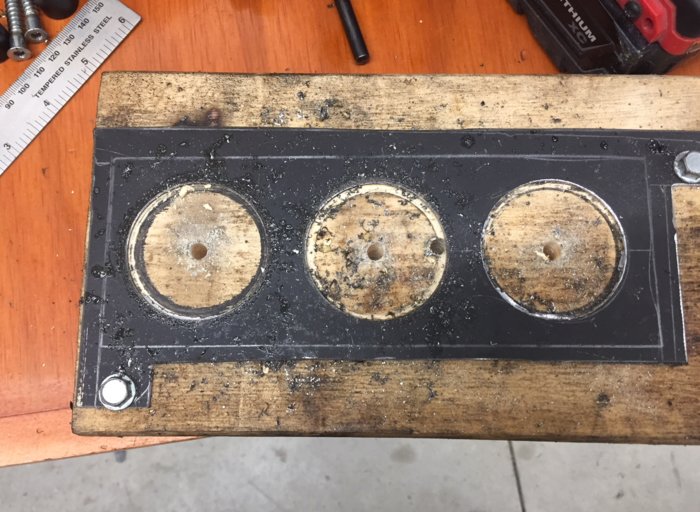

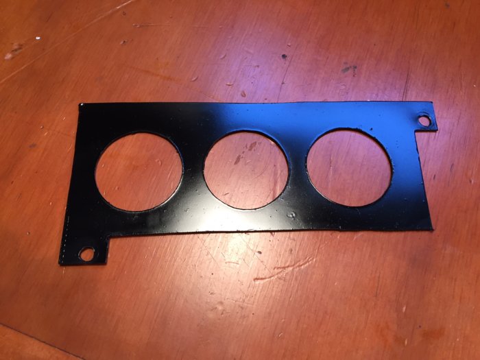

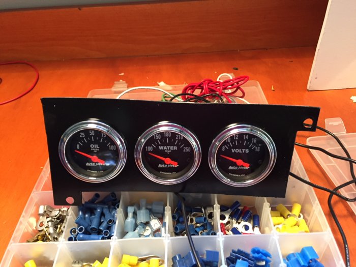

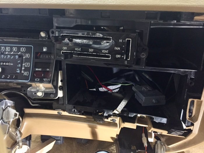

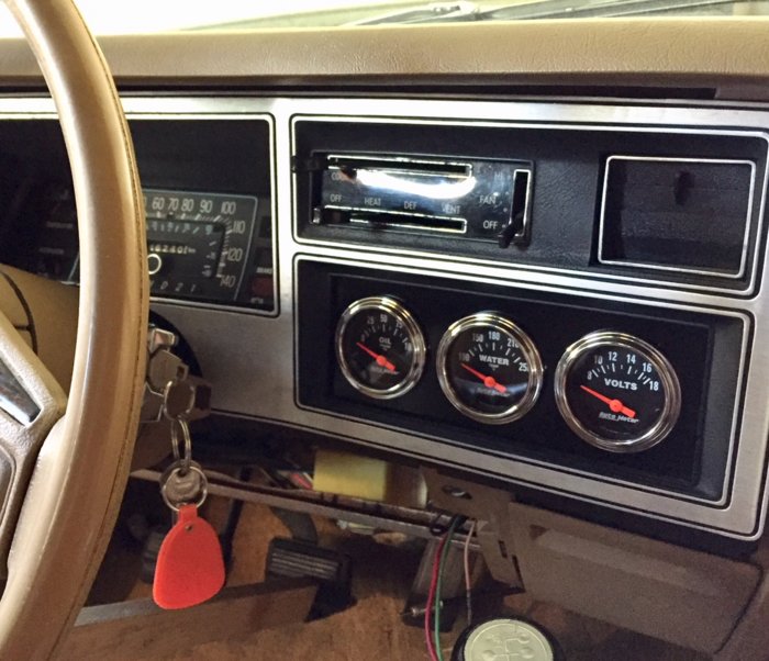

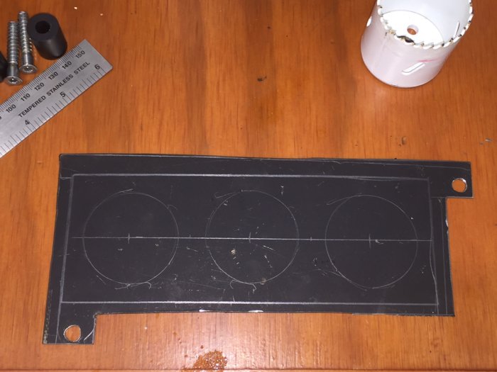

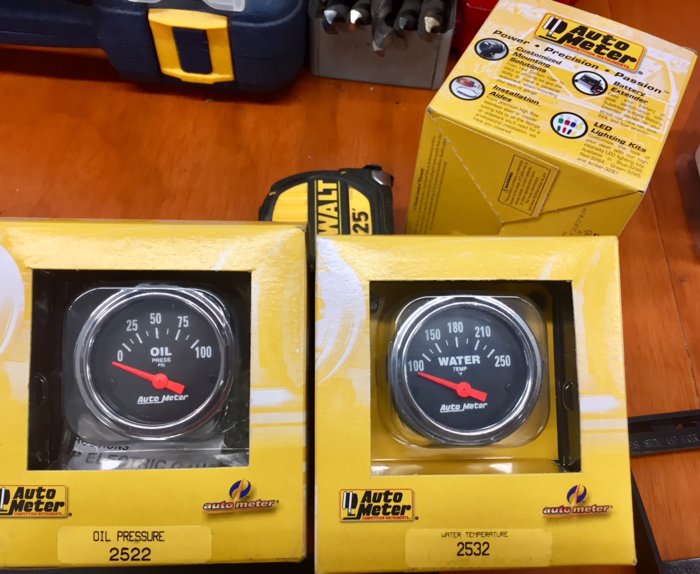

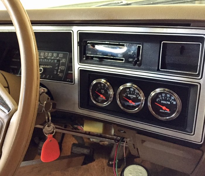

I thought it was maybe time for a quick wagon update. I still have not finished the rear axle repair and installation because I haven't had a chance to pick up the parts. I also still need to shampoo the carpets to see if they can be saved.
In the meantime I was looking at some Auto Meter gauges I had set aside but not used. I thought they'd look good in the dash of the wagon. Since the factory AM radio had long since disappeared and in its place was an ancient cassette player which I have no use for, I took a few measurements and decided to install them in the spot the radio would have been. I've included a few pics and I think the job turned out OK and looks pretty good.
In the meantime I was looking at some Auto Meter gauges I had set aside but not used. I thought they'd look good in the dash of the wagon. Since the factory AM radio had long since disappeared and in its place was an ancient cassette player which I have no use for, I took a few measurements and decided to install them in the spot the radio would have been. I've included a few pics and I think the job turned out OK and looks pretty good.View attachment 31450 View attachment 31451 View attachment 31452 View attachment 31453 View attachment 31454 View attachment 31455 View attachment 31456 View attachment 31457

Just got back from my summer in the north, Pa., and catching up on posts...glad to see another wagon in the group!!Yours looks like an interesting build and a all around fun toy.

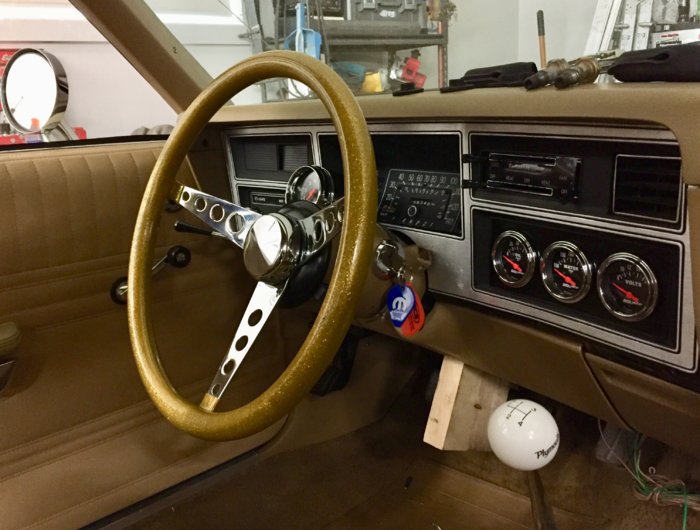

Now that winter is more less here in the great white North and other than going to work I try to hibernate it’s time to accumulate some parts for the wagon. I’m going to go through the suspension, steering and brakes to get it roadworthy. Wheels and tires will have to be dealt with. Since the the car has sat for the better part of five years I’ll flush all the fluids, rebuild the carb, do a complete tune up, hoses, thermostat etc etc etc. More than enough to keep me busy and keep my wallet empty. I was going to pull the motor and tranny but figured I’ll hold off on that until next year. Otherwise the project will spiral out of control and it will still be in pieces next summer. Here’s a few pics of some early Xmas gifts to me from me. So far mostly suspension stuff but a guy occasionally has to buy himself something shiny.

Oh boy! New toys! Love it! :) I also like the steering wheel.
I see you are using a wood block under the dash which I presume is to keep the clutch slightly depressed? I need to remember to do that as, when my garage was full of stuff from cleaning out a house, OY had to sit outside for a few months, and the clutch stuck. Wasn't fun trying to get it unstuck again. I was thinking of using my old "Club" steering wheel anti-theft bar to hold the clutch down a bit, but I'm not thrilled with the idea because it might cause problems with constant pressure on the steering wheel. This wooden block idea seems like a better solution. ;)
The wood block is holding the brake pedal down just a bit. With the rear axle out I didn't want the master cylinder to lose all of the fluid which would mean I'd have to bleed the entire system. I'm no expert but I believe having the brake pedal slightly depressed blocks the ports in the master and prevents fluid loss.
As for the steering wheel I've always loved metal flake and i thought it suited the unmistakably 70's colour of the wagon. A friend of my Dad's had a similar wheel in his custom Dodge van in 1976 and I still remember how much I liked it.
