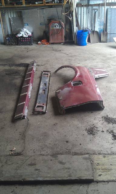

Only updates is that I've collected a few parts. From Jamison's parts car.
Left quarter, left rocker, and the trunk panel below the taillight panel.
Now that I've got some necessary body panels I'll be getting back on it when my truck's is back on the road.
