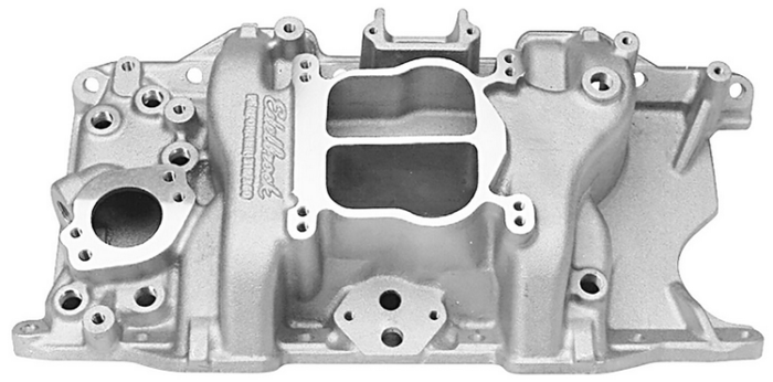

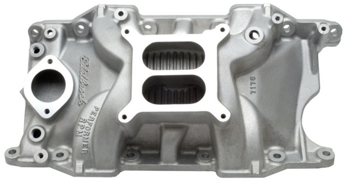

Using the Edelbrock Performer or Performer RPM?
Performer 2176 (or 3776 of with EGR)
Performer RPM 7176
The RPM version sometimes is too tall for a carburetor to fit under the hood.
Personally, I think the Performer is a great intake for a stock or slightly warm 318 - and it does allow for most carburetor usage.

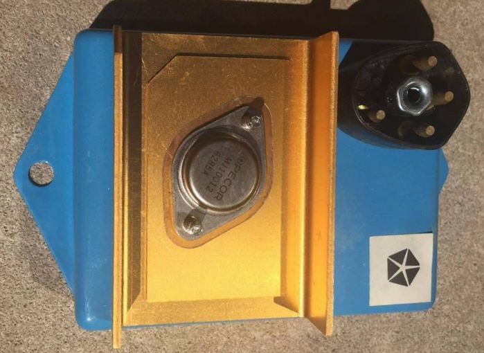

Are you using a Chrysler ignition system?
This can be black, blue or orange.
If not using a Chrysler ignition system, what system are you using?
