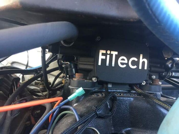

Because it was mentioned, I have an Edlebrock Air Gap manifold with stock 4 barrel air cleaner on my '89 AHB with FiTech and there's hood clearance.
