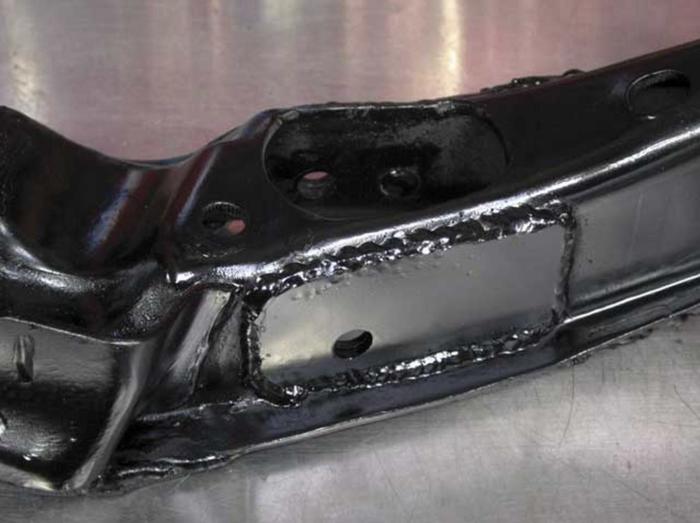

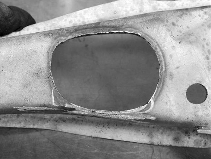

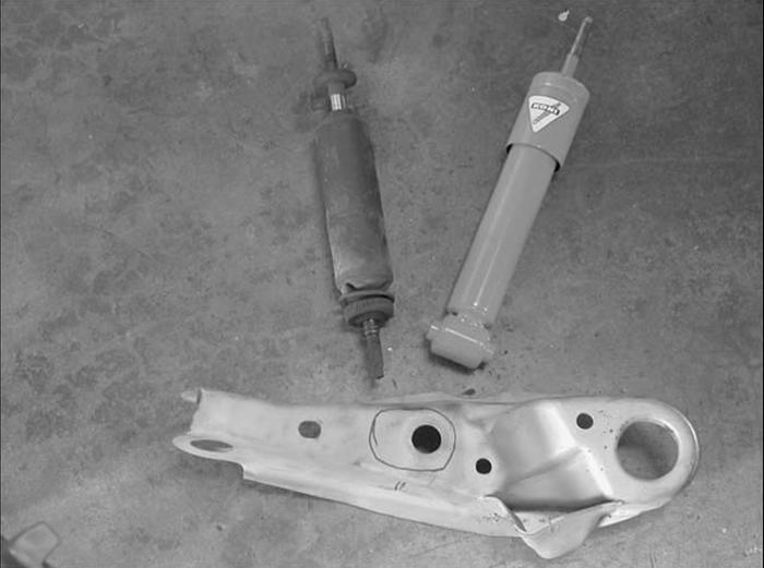

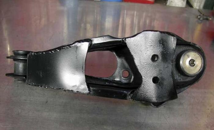

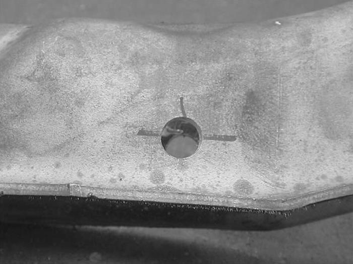

Any reason you couldn't do what Marko did with Stealth Bomber? It seems to add almost 3" to the shock tube length up front. Having it clearanced through the top of the lower control arm and secured with a bolt through the sides.
Front Koni "80-2660 SPA1" = Extended-11.69" Compressed-8.00"
Rear Koni Classic "82-1255" = Factory E body lengths
3,173
819
That is a tremendous amount of material removed from the control arm, boxing the lower portion would be needed.
But that looks to be simple.

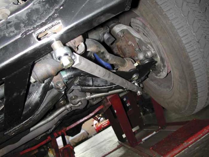

He did. And he added a spot for a heim joint strut bar.
"The Pivot Points Of Our Strut Rods Are On The Same Plane As The Pivotpoints Of Our Lower Control Arms. This Was Not Done By Accident. Bymaintaining The Same Pivot Points, The Lower Control Arm Bushing Willnot Be Subjected To Abnormal Wear From Twisting, And Will Be Allowed Toarticulate As Intended With A More Favorable Motion. The Strut Rodlimits Tension Conveyed To The Torsion Bar When Braking Or Driven Hard.The Torsion Bar Will No Longer Perform Double Duty As A Spring And Alocator For The Lower Control Arm, Allowing It To Do What It Doesbest Providing The Suspension's Spring Requirement."

This is done to the frames on 64-72 GM A-bodies to get a longer coil over shock and regain suspensionntravel
All of those would require extensive mods to fit.
No..the Ride techs won't require any mods.
You select what length and mounts to use
The Hotchkiss would needs mods yes

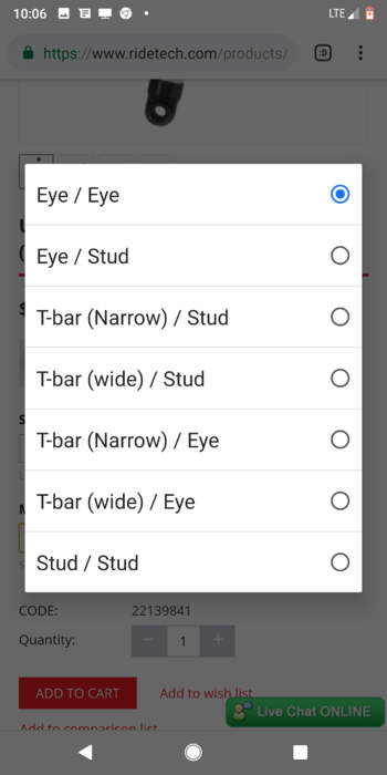

Ridetech 22139850 nearly matches the dimensions and stroke (0.2" shorter at full extent) of known good KYB stuff for the front of our cars.
Unfortunately our OE rear specs fall between 2 Ridetech options:
22179845 is biased 1/2" lower than OE.
22189845 operates about 1/2" higher than OE.
Personally I'd pick the lower of the two so I didn't blow out the shock on compression but I could see some of the raked crowd wanting taller options.
