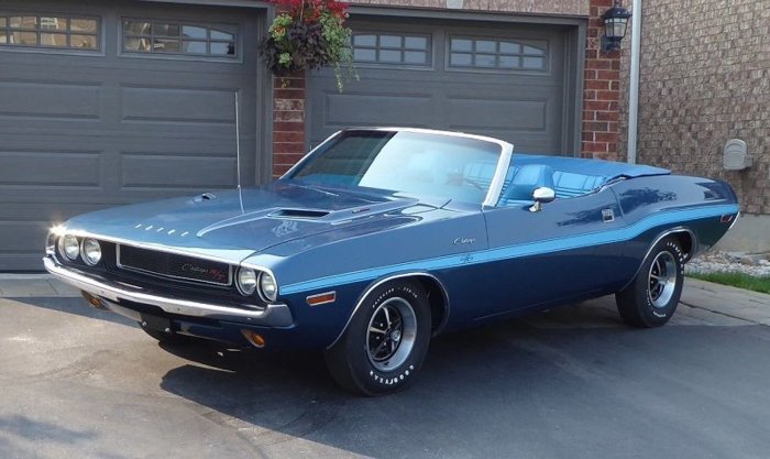

I think im gonna go with 1970 B7 because its a color that leaves many mopar guys wondering what blue it is. To me in the shade it looks like the 76 B5 and in the light the 77 B5.

That's the color my dad's '68 Coronet was, B7 blue. To me, it looked like the Challenger in the pic, going by memory anyways (car doesn't exist anymore:()

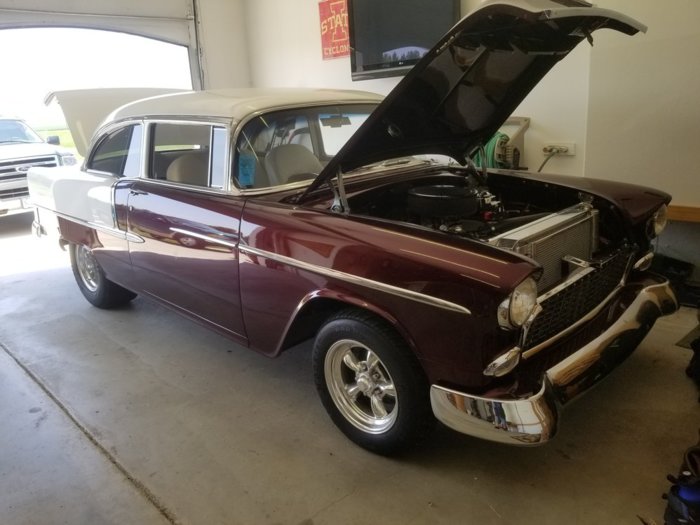

This one was painted in an open shop, HOK Brandy wine over black pearl and PPG Ice pearl over white. That's top bottom inside and out seventeen times around the car. That's ten months of work forty hours a week $$$$.

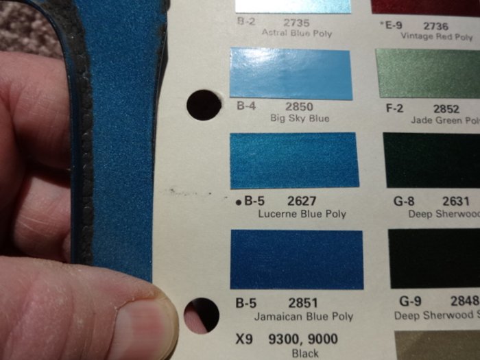

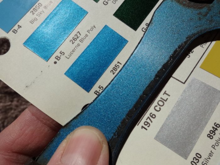

After much internal debate and looking over the other options on the car ive decided to stick with the oem 76 B5 color. Thanks for everyones help and input. This cars been indoors in dry storage for nearly 16 years and its looking like the good thick coverage on the underside will blow off easily with my high pressure steam cleaner aka The Grenade as I dont think they even sell them any more and in not sure mine inst even home made from like the 60-s.
I called my two paint guys and got them on the hunt to each mix a pint so I can see how close they come to being correct. I might have the base metallic toner here and its amazing how much old school paint supplies can be found on ebay.
Might not be the most exciting color, but different and correct. I snapped these pics of the grille bracket vs the paint chip.
