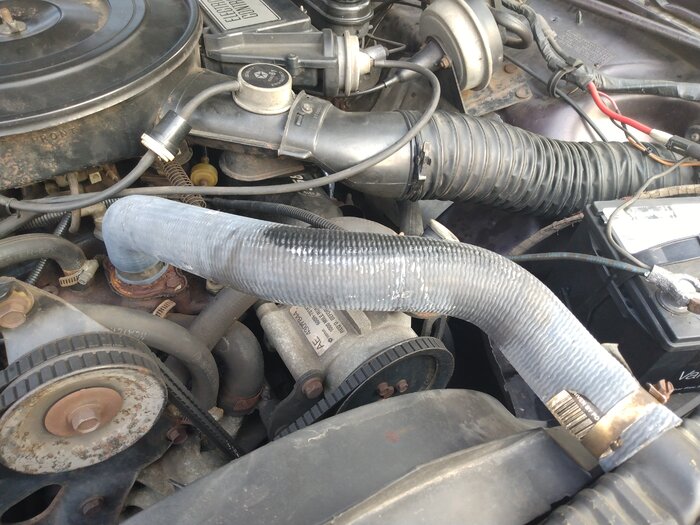

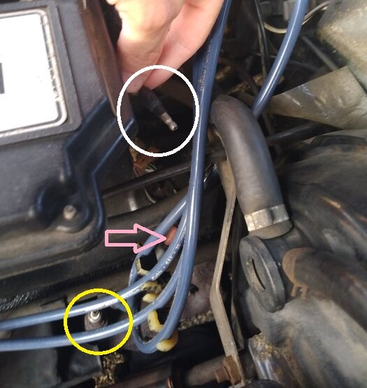

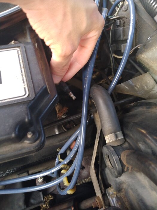

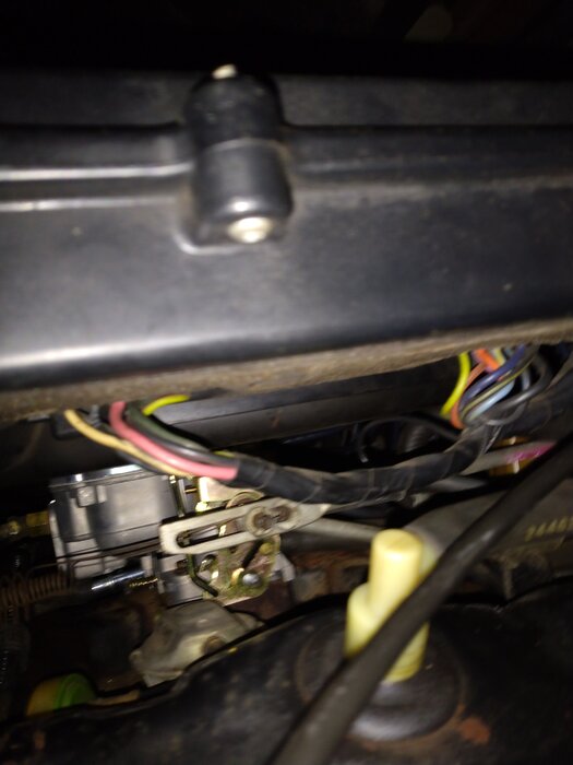

As far as the loose wire (white circle), it attaches to the oxygen sensor (yellow circle) via a orange pigtail (hidden but at the pink arrow). That wire becomes disconnected anytime the air cleaner is "re-located" and easily forgotten about.
I am not sure what you are referring to as to:
and look at this hose!

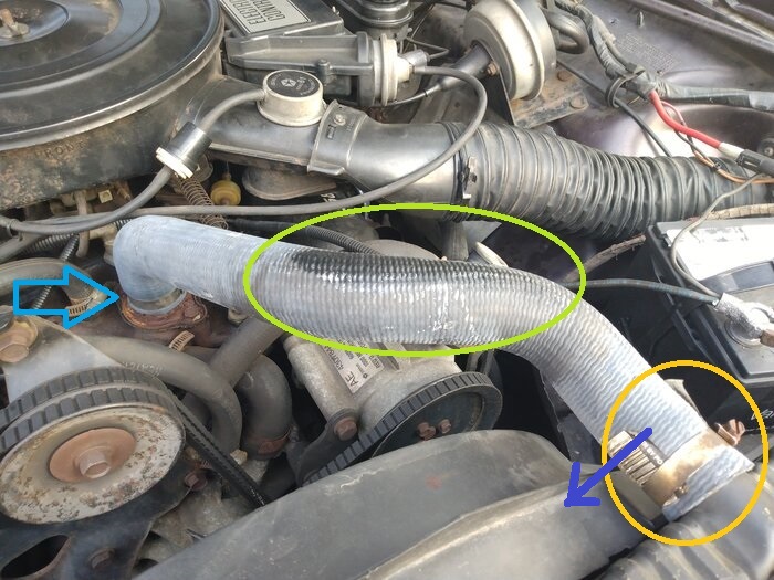

The area (green circle) is from hose rubbing against the hood insulation. It is neither a good thing or a bad thing. What is a bit off is the radiator hose is a bit long and needs to have about 1/2 inch trimmed off at the blue arrow. That will result in a bit of coolant loss.
The easier fix would be to loosen the hose clamp (gold circle) and rotate the radiator hose about 1/8th a turn and re-tighten the hose clamp. You might have a bit of leakage when that occurs but that much. You are not looking to remove the hose, just rotate the hose "clock position" a bit. that should keep the hose from rubbing the hood insulation.
NOTE: only do either when car is cool to cold. If engine is hot, you will (not if, but will) get burnt!
From this picture, I don't see any coolant leaks.

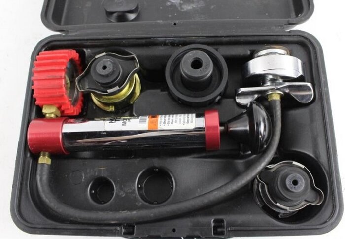

If you suspect you do have a coolant leak, I recommend going to a parts store and renting a "cooling system pressure tester".
It will look something like this:
Remove the radiator cap (WHEN CAR IS COOL TO COLD - OR YOU GET BURNT) and screw on the cap. Give the pump a few pumps and the pressure should remain steady. If you had a coolant drip, it will become a gusher. Some times you can hear the leak before you see it. This is a great tool to have and it will work with most all cars today (providing you have the necessary adapters) - but is pricy and not for the average mechanic. If you think you have a leak - this will find it.

looked like the hose had gotten white with heat and that hose has gotten very hot, though that hose being hot is pretty normal, the engine will smell kinda burnt at times, i'm almost positive i have little to no oil burning situation going on though. i'll top off the coolant when shes cold and perhaps spray some carb cleaner around to look and see whats going on. btw/ my heat gauge has never worked and the alternator gauge only sometimes. fuse is fine and i tried plugging it in further but i might just need a new one

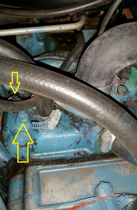

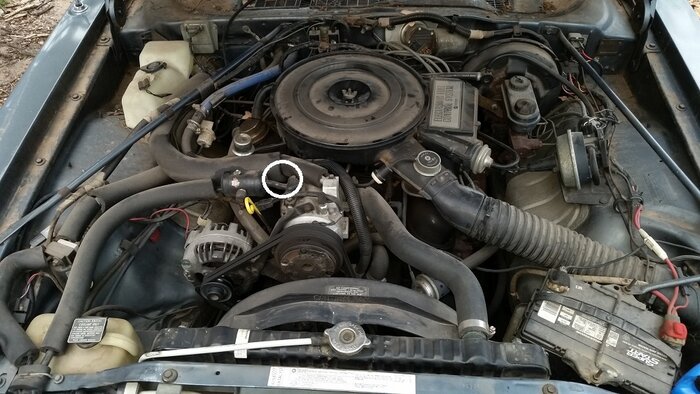

The temp gauge runs off a sensor on the intake right behind that pulley. It has a threaded end that points up and the wire should have a black 90 degree end to it that pushes over it.

In your case, I suspect the temp sensor wiring might be disconnected from the sensor or has another harness problem somewhere.
The general location of the temp gauge sensor is in the white circle (which is under a whole lotta of ____).
This is a better picture:
The sending unit is bottom arrow and wire is top arrow. Why both (and hose clamp) are painted blue - IDK.

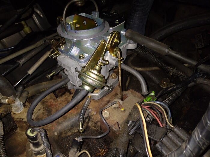

I've about had it up to here with this old car. every drive is hell now. gonna buy that carter now. hope that ends this. just got new valve cover gaskets and that did jack all even though one was indeed leaking. i can sort of see where there is a bit of a gap where the carb gasket is. i just really hope and pray that getting an all new carburetor will finally put this clicking, bucking, shaking, and stalling to rest. i really feel unsafe driving this thing now

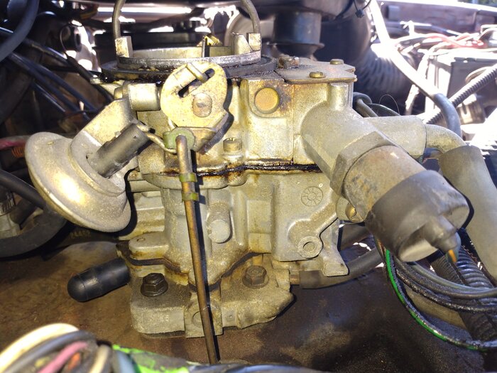

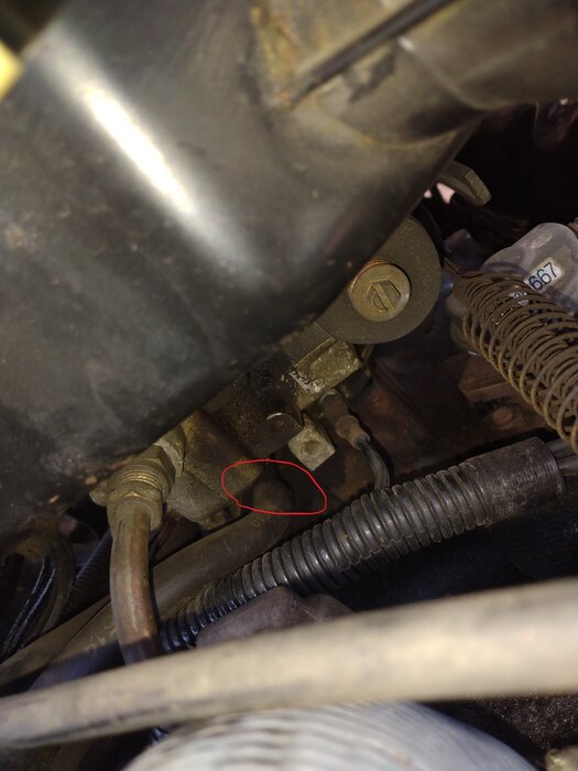

ok so i apologize for my little rant there. was just after a very hectic drive. after a bit of clearer mind i took a look and found a hose leading from the front of the car to the vapor canister (part number 18519) is bowing to the point you can stick your finger into its end there. its quite hard to see in these pictures as its hard to get the camera there. in these pics you can also see how the throttle body- float bowl gasket is leaking as well
1,494

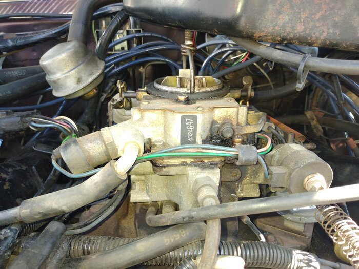

'88 Holley 6280 list# R40276. Chrysler p/n 4324647
Yes, the carb gaskets are leaking - but are not leaking that bad.
I recommending taking a new-ish Phillips screwdriver (not a wore out one) and hand tighten those screws and I bet that leakage drops. When I worry about leakage is when I see the side of carb or intake wet (from gasoline) and that needs to have more attention brought to it. What you have is something that I don't get excited about and can wait for another day.
If the hose marked by red circle is one disconnected - I can see how car will not run well.
You might want to make sure the end of hose is not damaged (split) and reconnect it. You might see if it works better if routed under the harness bundle, maybe.

just snipped that end off (cut my hand with the scissors, nice!) and got home with quite the nice drive. seems the old hose had just a little bit of cracking and wasn't on all the way. will try and tighten those screws later on. what is odd was the car kinda freaked out when i first took that hose off and reattached it without snipping off the end. i don't know but hey, i got home safe. another odd thing is the car mellowed out before i even messed with the hose on the way to buy better scissors. no idea what to make of it but hey, snipping that hose definitely made things better and probably could've saved me lots of money! the grime around there might be down to 30+ years wear and tear or the car flooded out long before i got it. never flooded on me as long as i've had it. (BTW i did relocate the offending hose to under that other bundle just incase there was a kink in the hose or anything)

went through and tightened up those screws which they didn't move much. car definitely ran better than it has in a while especially since its been getting cold. one odd thing the car will do is act as if its cold outside when it isn't (i take it you know how a not warmed up carbed car is like) choke issue idk, or me being impatient as usual. one thing i did want to ask about that BBD you recommended and i feel i may have already is. what about the wires the 6280 has? with this part need to be retrofitted onto the BBD? i know there are lean burn BBDs as well. i have a 6280 rebuild kit as well so i might just go with that though my mechanic says "get rid of that bakelite crap!" one final thing. would you happen to know where i can find the plastic piece that holds the headlights up? both broke on the passenger side

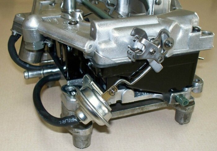

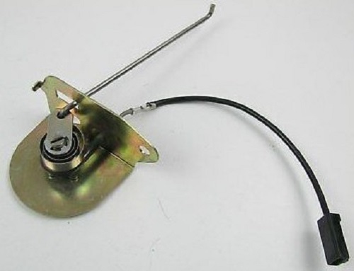

The choke thermostat has a bi-metallic spring in it which opens/closes the choke plate when engine is hot or cold. Over time (~15 years or so) that spring gets rusty and/or wears out to point it doesn't move much. I recommend replacing the choke thermostat every 15 or so years and that (as well as other carburetor adjustments) should make car much more driveable regardless of temp.
Note: the Carter BBD and Holley 2280/6280 are different and shouldn't be interchanged. They do look similar, though.

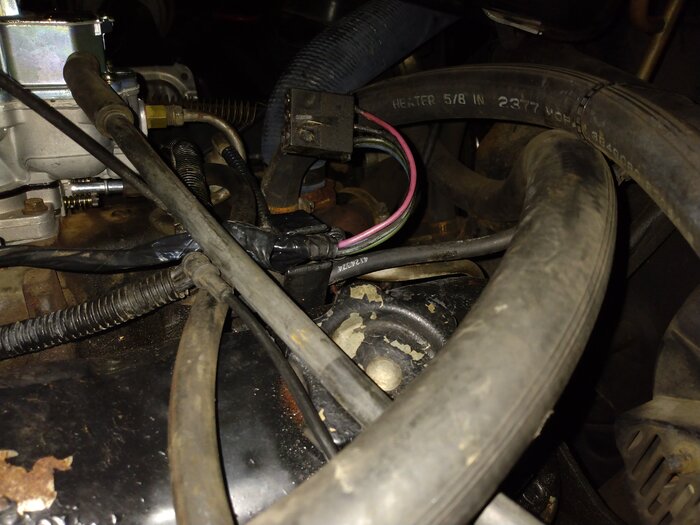

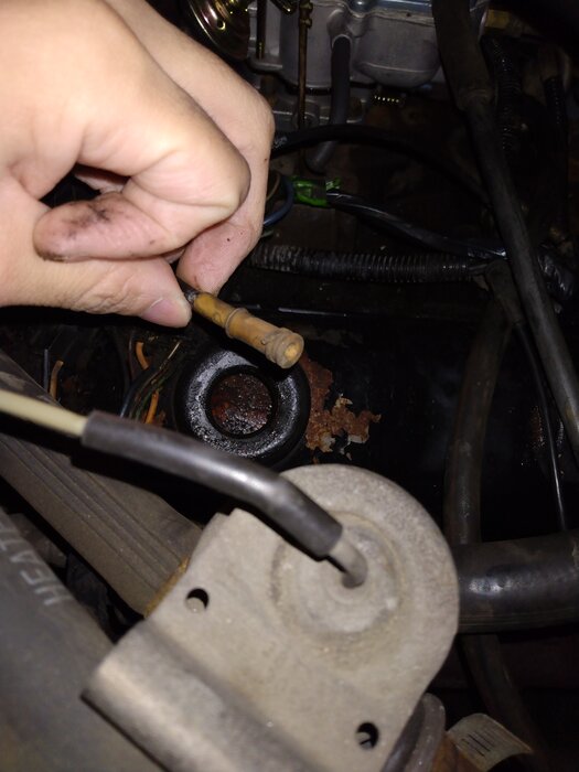

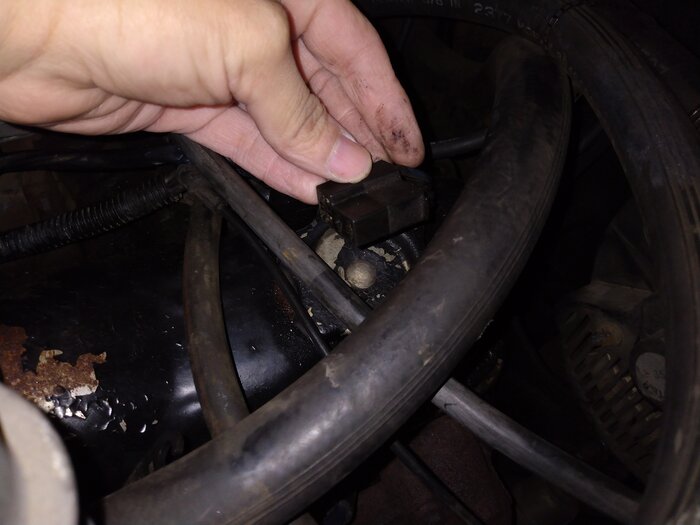

found these things unplugged. could be a culprit? just when i thought it was all over. i notice ever since i got her back too, she bucks forward when shifting into drive too. i hope one of you can point me towards fixing this issue. i'm not sure if i wanna go back to the shop so soon
