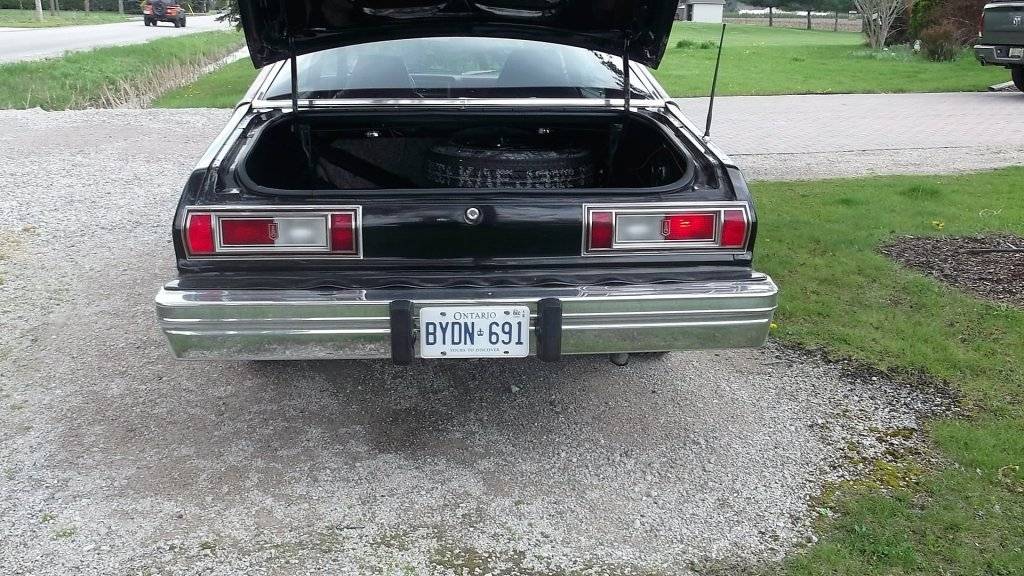

I put Plasma Led lights in ........ wasn't worth the trouble nor and especially the expense ....... 3rd brake light was a better deal ........ I'll post pics .. when the weather clears .. been cloudy and raining since Sat. and today is more of the same. Here is where I got the Plasma Led.

Regular Led aren't any brighter than standard 1157's ... these are minimally brighter .. just barely. there is a u-tube comparison if you scroll down.
--- Post updated ---
Oh and I forgot to mention .. the Volare flasher unit worked fine with them installed and the plasma are designed to work as regular bulbs, didn't work on my other car, but then it has a small motorcycle battery in it, don't know if that affects it? .. some cars need to go to a no load flasher unit and I've read they don't click loud, another option is a resistance load inline, but then there is no benefit for the battery. Best I can say about Led is that they are instant on and with the charger on the battery at full charge .. the charger didn't turn on for at least 15 min. of park lights being on.

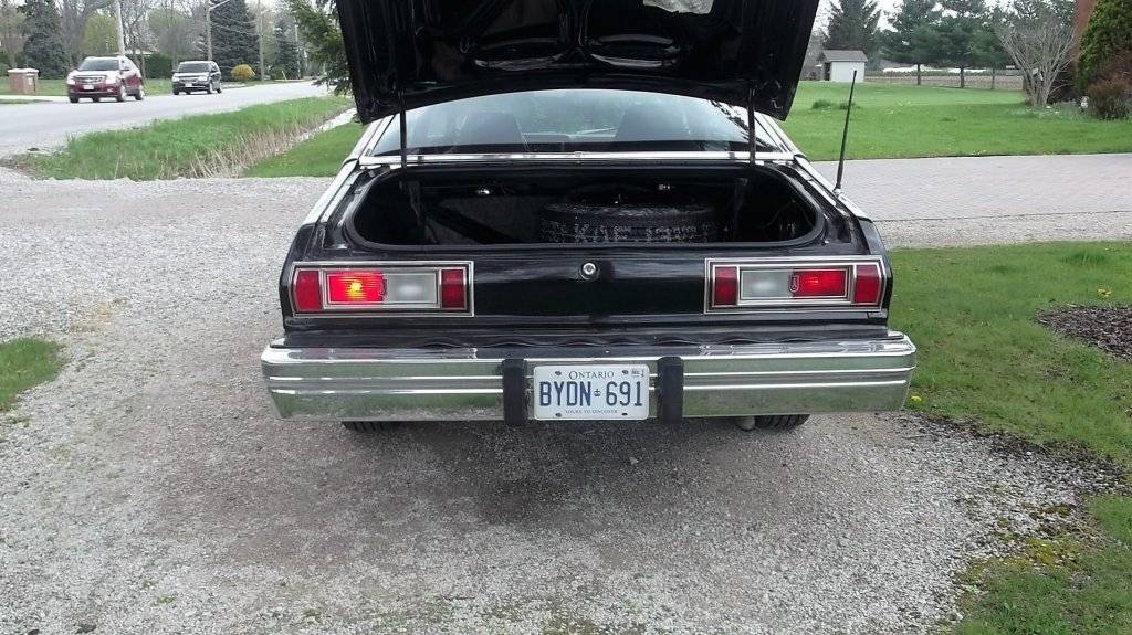

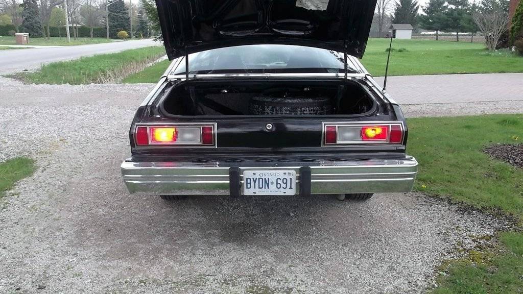

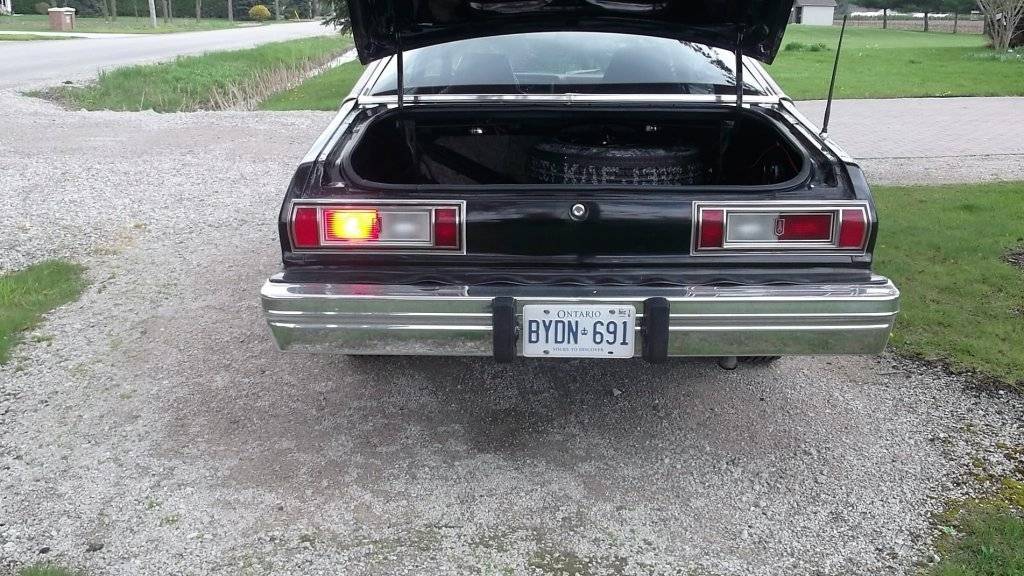

These loaded different than taken .. I have no idea what's what .. maybe we can figure them out ?? computer illiterate .. camera stoopid !! left side has the LED ... Another tidbit .. Led needs to be the colour of the lens
brake light ?
L turn
R turn
parking lights

Oh my -- you are my hero.
Narrows down my research and lets me know not to make the mistake of color bulb behind the white lens.

Other than the led rule of match the color to the lens, are you satisfied with the lights when you drive at night?

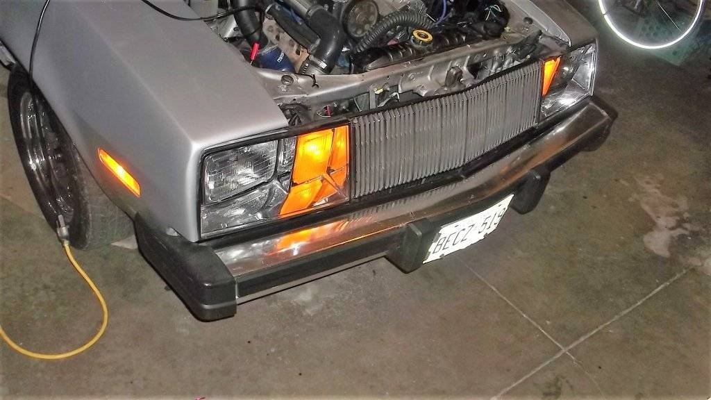

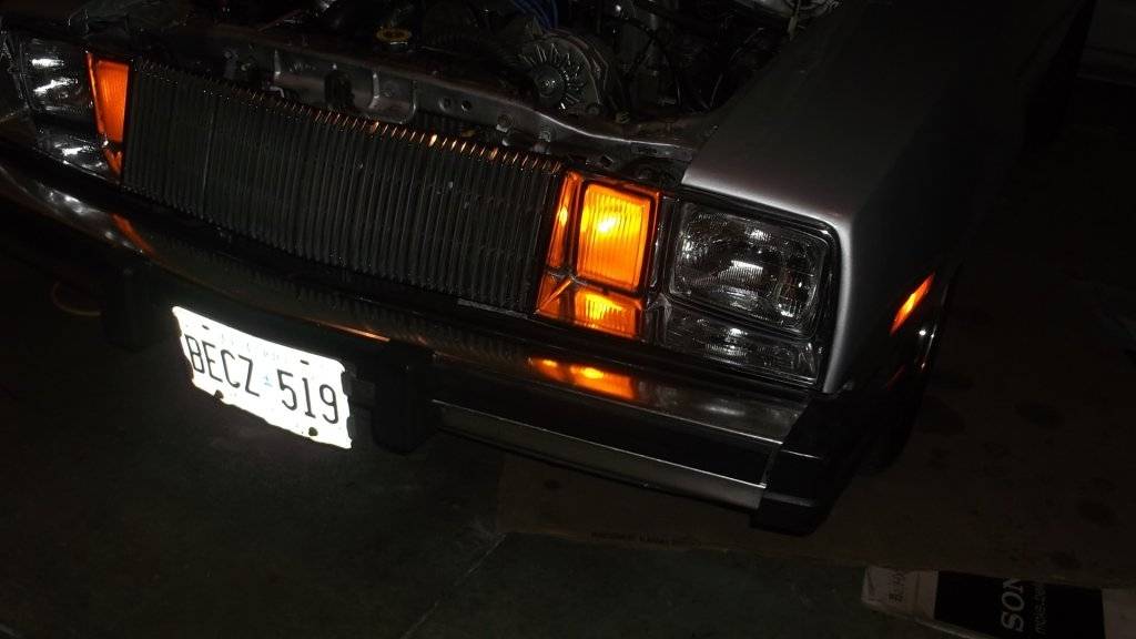

Thank you .. I was preparing to install DRL's on both my oldies .. but then for some reason I never went through with it (Dan Stern from Allpar never got back to me ??) .. they work as intended and I like the safety factor in the brake light being brighter than normal .. but don't believe their hype .. they are brighter but not by much .. a good quality LED will have enough light emitting diodes to light in all directions .. not sure if DOT approved tho? this is a pic of amber bulb with amber lens in lower light .. notice how much better they shine .. lol
the flash must of gone off on this one??
If ever there was a car that needed brighter brake lights .. it's this one .. (think Pinto .. lol) but the flasher wouldn't work with all 4 so I only changed the fronts .. again preparing for DRL's
