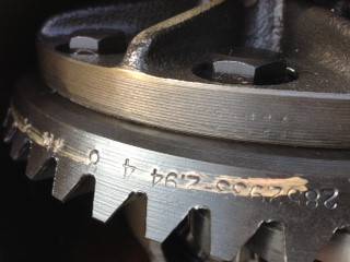

Hi Guys,
I don't know much about axles, (we call them diffs here in NZ) anyway I am looking at the 7.25inch to 8.25inch upgrade, I have located a 8.25" open rear end out of a wagon that had a 4 speed OD box in it. The guy didn't know the ratio so pulled the cover and sent me a photo. I can see it is a 2.94:1 ratio but my question is that when you look at the gear you can see on the V bit in the gear it looks a bit rough, is this anything to be concerned about. See Pic
Thanks
Bruce
7,323
2,971
No, that is completely normal. The gears don't mesh that deep. Brand new gears look like that a lot of times.
2,978
697
I just had my diff cover off yesterday on my 8 1/4 and it had the same or similar grooving going on. I figured I was not hearing it, so it must be ok. I have heard that familiar diff hum before and then soon there was nothing...........
