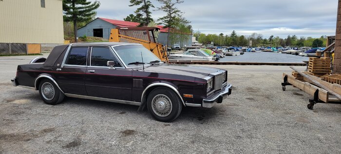

I normally drive an 01 diesel volkswagen to work (75 mile round trip), but it has been down for a steering rack replacement for the last three weeks! So I have been driving my 88 5th, and it has been extremely enjoyable :). The looks you get, and the heads you turn is a good time.
Luckily I get free fuel from work, cause 290 miles to a tank aint gettin me too far! lol. Not when I am used to getting near 700 miles to a fill up.
