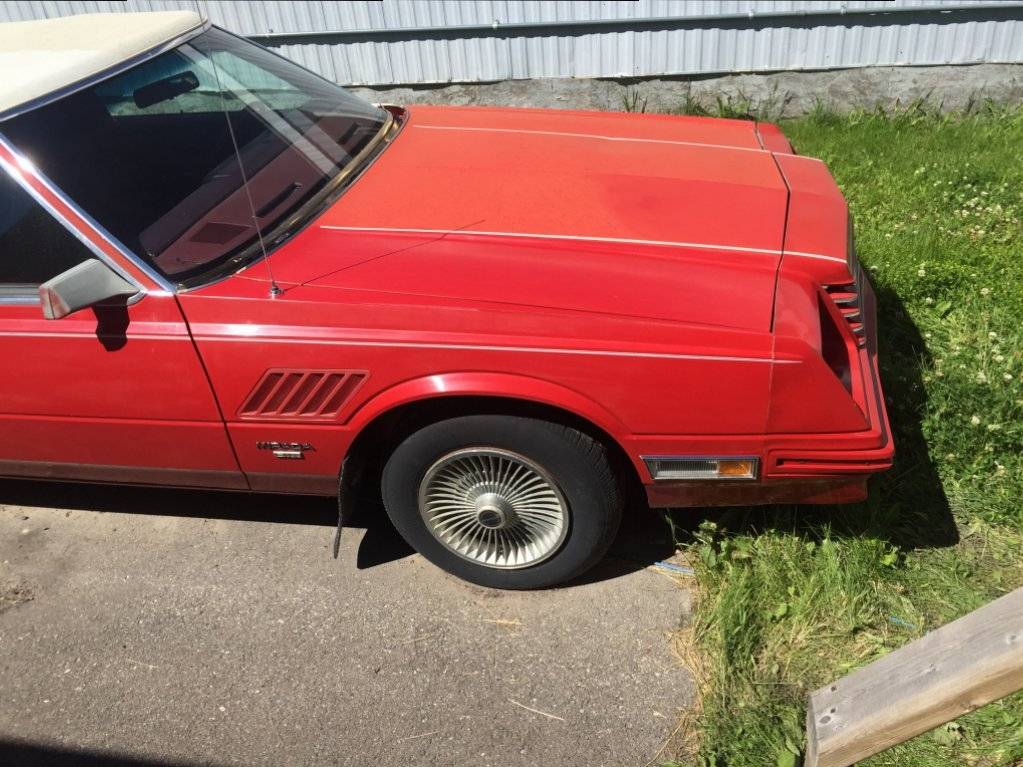

I will post pictures up tomorrow of a test section of the same trunk lid after some brief experimentation with some Meguiar's #1 medium cut polish. This will be pretty useless without a picture to back it up, but I am very encouraged. Funny thing is, the more I do things with the paint, not only is it looking better in terms of overall appearance, the color is getting redder as opposed to somewhat orangy coloured the way it was before..

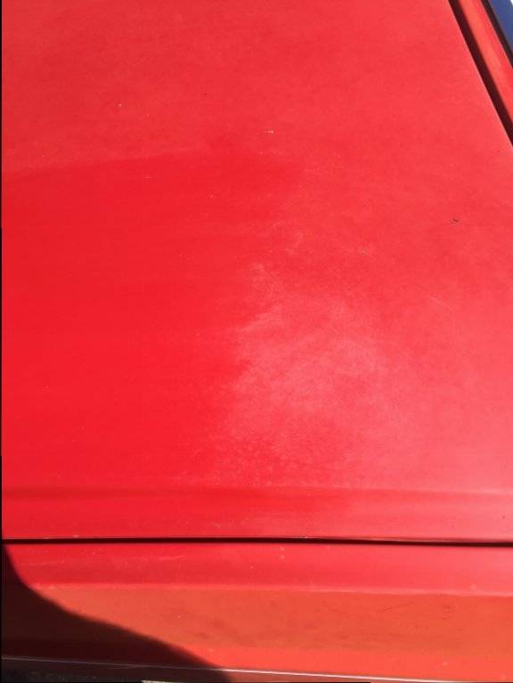

As promised, pictures after using some Meguiars #1 (I felt that the oxidation was severe enough that #2, a fine cut cleaner, would have been ineffective).

I took the picture this morning, but actually used the Meguiar's #1 the trunk lid last night before I went out. It feels a lot smoother when I rub my hand over it, and we had some rain last night. When I came back, it had stopped raining, and I noticed that in the area that I had applied the polish to I had water beading up (water beading up is an indication of the smoothness of the surface). The area that had not had the polish applied wasn't beading up at all.
I think what I will do is wash the entire car with the dish soap first. Then use the Meguiar's #1 to get the paint cleaned up reasonably well. Wash with car soap, and try the clay bar, just to get the paint really clean. Then wash again with car soap, and repolish with 3M's Imperial hand glaze (a super fine polish, just to try to improve the shine), and then wax. I have a few weekend's worth of work ahead of me.

It appears the paint is coming back to life pretty good! So,,,,,,how are your arms feeling so far?:D

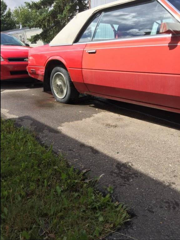

I have not had the chance to do much, but did get around to cleanin the paint on the rear passenger side. Seems like that side had less paint damage than the trunk lid did. Took a picture, which will make the difference a lot more visible than the trunk pictures did.

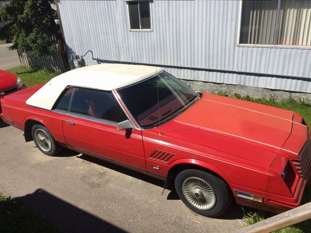

Progress, along with a vinyl roof experiment that seems to be working out well. Pictures as of this afternoon:
