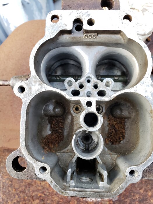

I found what was plugging up the idle jets. I couldn't see this crud until I removed the float assembly. Pretty bad sediment deposits. I'm hoping it came from the previous gas tank as it had a new one when I picked up the car.
I replaced the fuel filter when I first started it up and it has stayed clean. I'll post my pre and post rebuild adjustments tomorrow. All I can say for now is this carburetor works amazing when it's clean and adjusted correctly.
