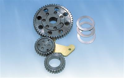

Looking through some cam parts, I found a gear drive for a SB. Had one on a hemi but never a SB. Might be the solution.

A gear drive would be the best solution...but very few choices in the SBM product line-up, and most are very expensive, at least the ones I've looked at were.
I have no experience on gear driven camshafts (yet). I’ve worked on a few small blocks and have seen some that looked extremely dry in the timing chain area (which was what I was replacing to begin with). The reason for looking dry was never looked into (wasn’t getting paid to do that . . .).
That said, most small blocks that I’ve been into, the area/parts was wet – so not sure if some people kept the engine oil level low (accidently or on purpose) or what was going on.
The reason I bring it up, is there is a number of additional bearings involved with a gear drive setup – and a lack of sufficient lubrication could spell disaster on some engines.
Having the police style engine oil cooler (which sprays the return oil onto the timing chain) – might be a key to longtivity (spelling?).
Granted – I don’t build engines to race with, so racers might not have any problems. I’m more thinking of people who drive cars 100K+ miles or more between rebuilds.
