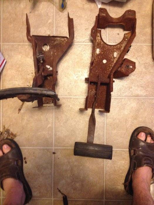

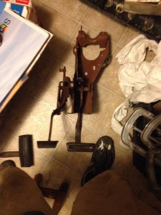

I told you the pedals are not the same, and that was the only obstacle, once you have the basic assembly, you can get every thing else. Even the floor hump could pretty much be worked around with a b-body one, would require minor fabrication. the 4 speed carpet ($160)is like he says-up to the back of the front seats, and another four door automatic carpet overlay to the rear seats. walmart has similar square carpet material (sometimes they carry it) that is 10 X10 or more for $20-30 bucks that could be utilized for the back.
I suppose I should upload my photos of the 4 speed assembly here as these guys are more motivated to identify what's left of my floor pedal collection for your car.
