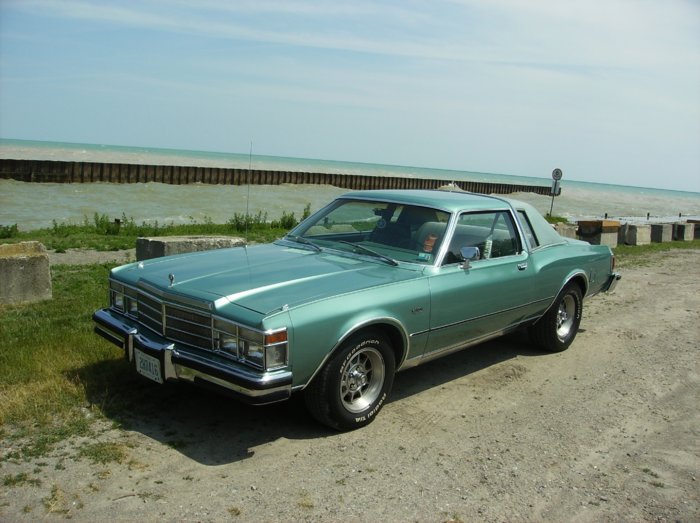

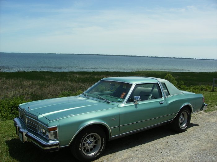

I just took my 79 Lebaron on a 200 mile 6hr tour last Thursday and I'm doing it again on Monday.
If the car is serviced on a regular bases , fluids are OK and not pouring out, what's the problem?
I D/D a 86 F/A and use a 79 Medallion as back up and they'll go 300 miles without a worry.
