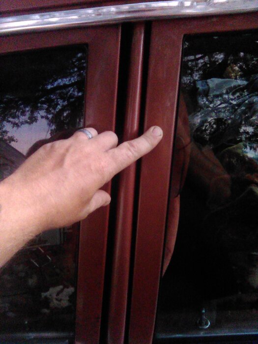

I found an '80 Diplomat in a u-pull it yard that has a right side mirror and no power windows or locks like mine, except it has chrome trim around the windows which mine doesn't have, can it (the chrome) be removed? See picture for what I mean

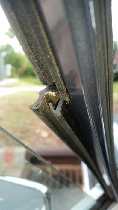

How to remove the trim - I am not exactly sure. I would guess you will need to remove the felt/rubber-ish window run channel that door glass runs up/down in (it just pulls out - but glass might need to be down all the way, or removed, possibly).
This picture was taken from my '86 Fifth Ave. It is hard and cracked - so I pulled out part way, with my fingernails, to show what it looks like. I suspect the trim clips on just under the window run channel.
This from sitting inside the L/F seat and with door (and glass) cracked open a bit. The window run channel has been broken on this door ever sense I got this car ~15 years ago. The chrome edge is there and just not quite visible.

Earlier this evening, I went to my '86 Fifth Ave, to pull out the window run channel out (at the crack) to look inside the metal frame. The rubber/felt run channel is so hard - I couldn't get it to buldge. Five years ago, it was very hard. Now, it is like bending stone (or rock).

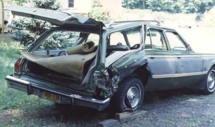

I was lucky I saved them from a '76 Aspen SE wagon that had been my Dad's, and then mine after he passed. Not long after that, I got rear-ended by a drunk, but before it got flatbedded to the junkyard, I pretty much stripped off everything I could. Those chrome Ventshades had been put on by my Dad, and fortunately I saved them. They are pretty hard to find now.
Sorry about your Dad's Aspen. Yah they are hard to find, there's been 4 M-bodies at local u-pull it yards and none had the visors, I used to have an '82 Fifth Avenue with them, I should've kept them
