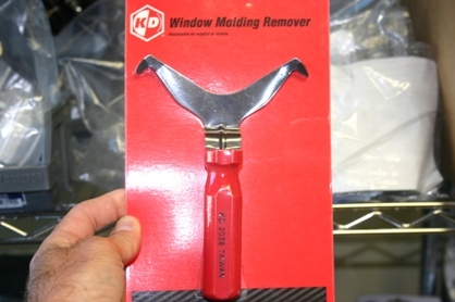

Need a special tool.

Apologies for piggybacking on to your thread, but I can't figure out how to replace the windshield molding trim on my 1984 Fifth Avenue. I'm guessing you do?.
Any help would be much appreciated, I'm in the UK and can't find anyone over here who knows how to do it.

Go up a few posts where Dr LeBaron posted the trim tool. It is a must have to remove the trim. It slides under the trim and then you pull it across until you hit a clip. Then, you rock the tool. The tool releases the clip and you just keep going around until all the clips are released. Without the tool all you'll do is bend the trim.
I looked for a GOOD video on the procedure but all I found was crappy ones that don't show much.

OK, I found out how to remove the side window trim. If you take a tool similar to the "hook" tool for getting a radiator hose loose. Lower the window, insert the hook under the edge of the trim and pull HARD. be carefull not to bend the trim. It is just pushed (tightly) on to the edge of the window frame. I'm not sure if it can be done with the window run channel still in place. My channel is very bad, and falling apart. I have NOS channel for the front door windows. Need to try and locate channel for the back door windows.
