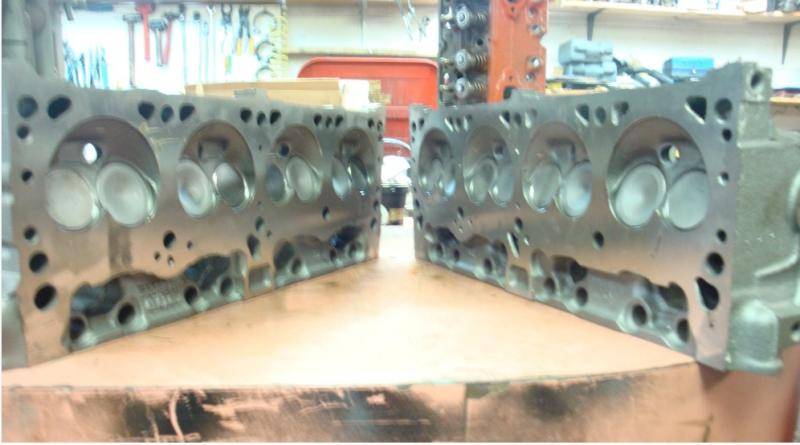

yes, but my valves are smaller and shrouded quite badly
I still like your set up better. You're comp will be higher than the motor in the video. The smaller ports will due well at the rpm you'll be operating the do a at.
Using a thinner head gasket might net a little more comp too with your set up.

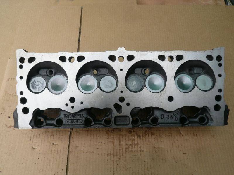

BTW - Those heads are not my own heads, just a photo of a 714 head, my heads are still in transit. My heads are on there way to my friend in SC who will add to my pallet shipment to NZ. XXX302 heads are hard to fine, its taking me a while, the head reconditioning place had never seen 714's before until now, they had seen the 302 castings but not the 714's they are not easy to find! I decided to buy reconditioned ones out of the USA as buying used ones I don't know if they are cracked and the ones I have bought have been crack tested and rebuilt.

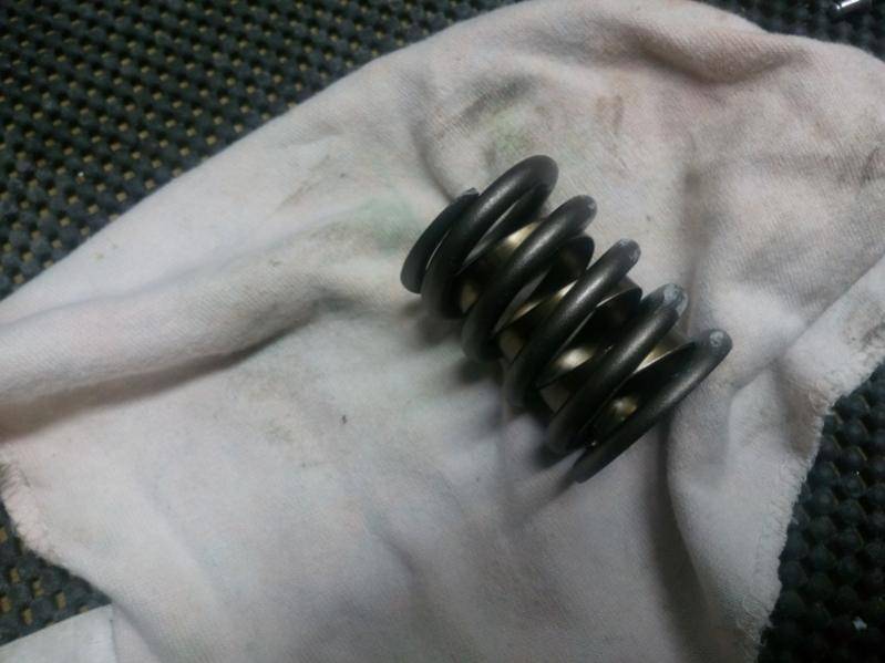

the "flat spring" is a damper, diesigned to stop the main spring from oscillating. Without it, at some RPM points, the spring can start to oscillate, which will mean loss of spring pressure and valve train control (used to be called "floating the valves"). It doesn't mean that this is a good or bad spring, as I don't know Falcon Performance from a hole in the wall, but that is what the inner coil is for; it si fairly common for straight wound springs (as opposed to barrel wound (often with oval section wire, also called "beehive springs"), conical wound, or springs wound with a wire that varies in diameter along the wire length. All of these valve spring designs are trying to eliminate (if possible) valve spring oscillations. Some times, some manufacturers can combine a few concepts (conical wire spring with varying wire diameter for example) when really large/heavy valves are to be used in high RPM motors (think Hemi big block valves at >7000 RPM).
The presence of a spring damper is just a design choice. It says nothing about the spring quality.

I suspect like cams that there are only a few manufactures of head springs, my cam is badged Elgin but it is the same as the summit 6900 cam, prob same with springs.
I am only looking at turning the 318 to 5000rpm redline so I hope the springs will handle it all ok!
