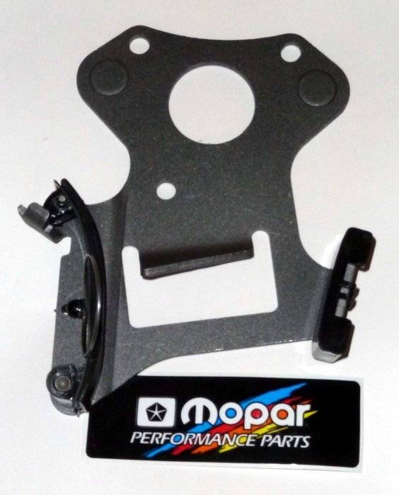

If you are changing the camshaft or timing chain, I would highly recommend getting a timing chain tensioner. They are available aftermarket, from Dodge and from Mopar Performance. They fit all small blocks (even the V-6 used in pickups). As long as it looks like the photo below, then you are good.
Now with that said, I wouldn’t go through the trouble just to add this item - but if you are already in the area, then I would highly recommend adding the tensioner.
As to your original question, I would rather let others answer.

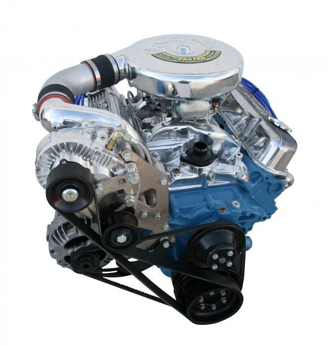

friend has one of those Paxton setup on a magnum 360, 600hp but change pulley for 800hp if he needs it, well so far everyone seems a bit quiet on a combo for me :)
