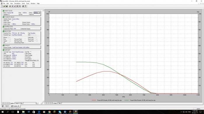

I have desktop dyno 2000, I don't expect it to be 100% accurate but more of an indicator of what you may expect, I found the head flow data of a stock 302 head, put the 360 size valves in, dual plane intake, 770 cfm carb, headers with mufflers, I entered in cam specs, engine specs, headers, the comp was set at 9.5:1 but may be a little to high, maybe 9.2/9.3. Anyway you can see all the specs in the side, here is the plot, maybe we can all diagnose it together and see what we come up with.
How do you make the picture bigger so you can see it???
Green line is TQ and its at 395flbs @ 2500rpm and the red is 277HP @4000rpm

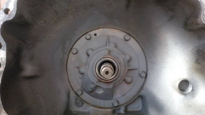

Btw here is a photo of my non lockup 904. The code says its an early 1972.
Barracuda Early 72 8-318, Challenger Early 1972 8-318, Dodge early 72 8-318, A94-1 Std duty, Plymouth early 72, valiant early 72 8-318.
It came with my 360 was told it was a good trans! Is there any tail tail signs it may gave had a rebuild?? I noticed its painted inside the bell housing. See pic.
Thanks
Bruce

I won;t comment to use or not to use your new torque converter – but you can use both transmissions (904 and 999) to make a transmission to fit your needs.
Either A: move non-lockup components from 904 and transfer to 999.
Or B: move geartrain from 999 into the 904.
Both routes will require transmission removal.
In the past, Lockup wasn't considered to be a performance part. I think things have changed and for people who will be driving the car, the fuel mileage benefit (of roughly 10%) will pay for itself for the trouble of making sure transmission has a working converter lockup. Performance will not suffer using a transmission with lockup as long as correct converter is used for your combination.
Bud makes a good point.
And I have married these in the past. But this one thing is of utmost importance; The mainshaft and planetaries MUST be kept together. They will physically interchange but the splines are different. If you mix them up you will shear the hub out of an aluminum planetary in as little as 25 miles with a teener; Don't ask me how I know. With the naked Eye, you cannot tell them apart. So be forewarned; keep the geartrain well separated, or Ziiiiing!you are walking :(
