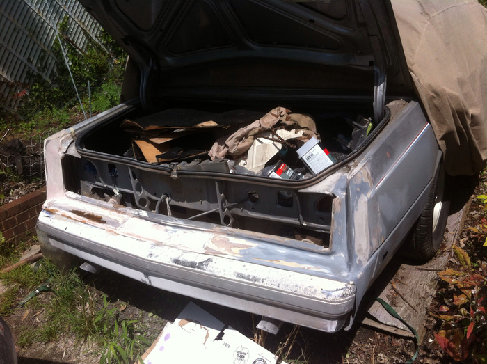

The rear filler panel on my '82 Cordoba has started to crack, along the bottom. Has anyone successfully repaired theirs?

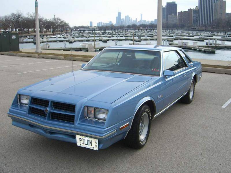

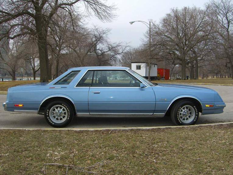

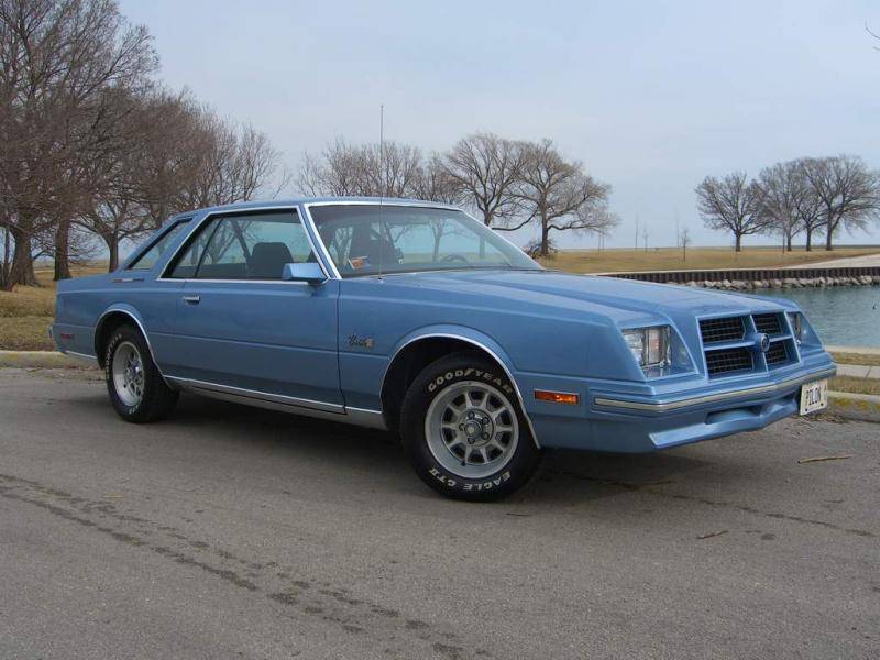

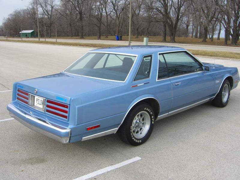

You sure can. The rear valance and extensions on this car were all fixed with fiberglass, epoxy, and sand-paper. I bought those plastic replica pieces, but they were really, really bad. It turned out to be much easier to fix the existing units. Wasn't that hard. Fiber is very forgiving. If you sand too much of it, just add some more, cover in epoxy, and sand again.

This car was originally white. I don't recall the exact color name, but this was a budget paint job at a budget body shop. This work cost $1,400 US. I asked for "extra clear" -- and the shop obliged. The only downside to the budget products, was the paint lost a lot of shine after about year 3 -- but I was also fairly hard on the paint (read: An occasional trip through the automatic car wash).
Is it a straight color or a metallic?
