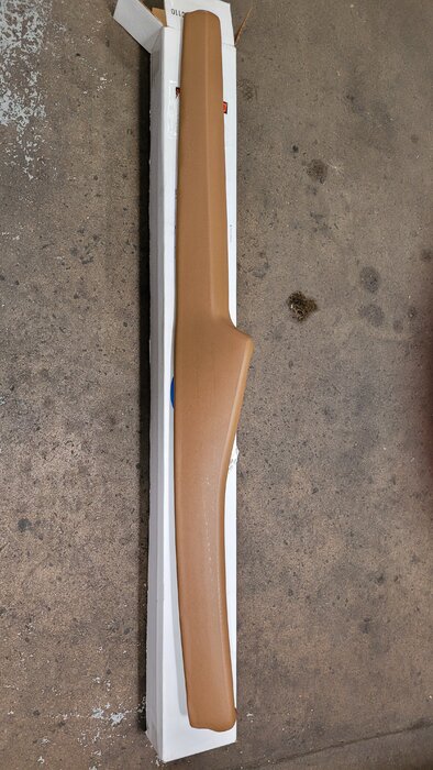

I had my dash pad recovered by ABC Moparts.
I am very pleased with the results. They were able to match the original tan interior color. The original pad was sent and they used it as a color sample.
See attached picture.
I hope the forum finds this helpful.
What did they charge to redo the pad? It looks beautiful!!!

Their website says "from $349" for the pad. It doesn't specify but maybe colors other than red or black are slightly more?
Sounds like a lot but, considering the work to strip the pad to the bare frame, attach/mold new foam, mold the new vinyl, etc., not to mention what it cost them before the first one was made, it's priced darn reasonable (JMO).

I have unfortunately misplaced the invoice, but I do not believe that they charged a premium for other colors. There was a rather long lead time, months, to get the proper color material.
