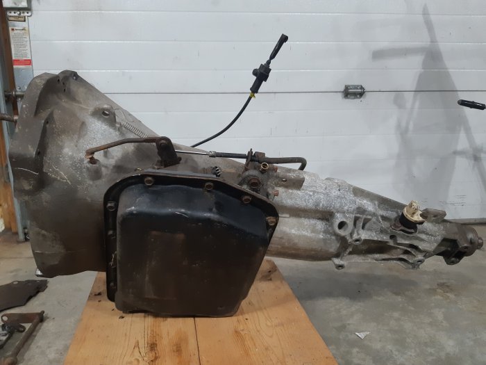

Thanks for the quick reply. I know it is an RH version as it only has two electrical connectors; a 3 pin (12V, OD, TCC), and 2 pin (neutral / park). As for the pan, below is a picture - hope that helps.
1,806
1,014
That's a 518/46RH. The 46RH designation was just a name change for the transmission. It's based on the 727.

You're the man!!! Brilliant, I was hoping it was a A518 / 46RH. You have no idea how many hours I spent trying to determine what version I have.
Thank you!
