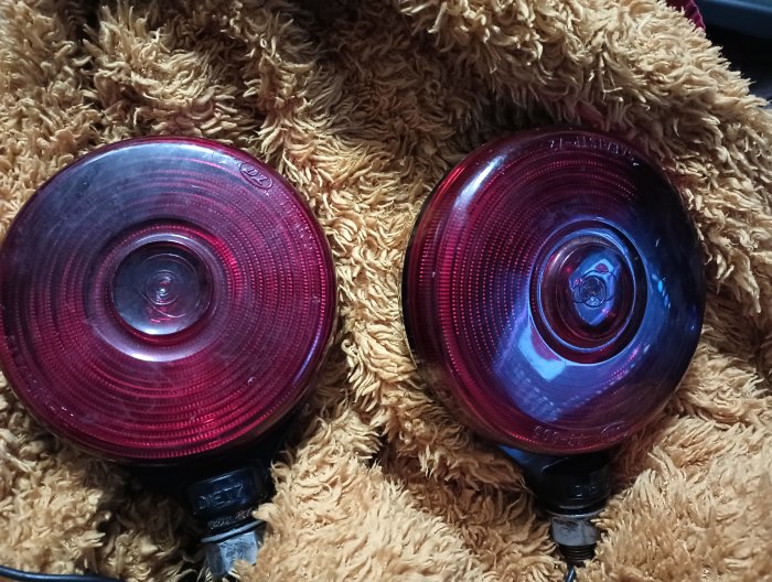

i was fortunate to pick up a pair of old dietz brake lights at Carlise last week. these were put on the rear decks of many police cars in New York and Pennsylvania back in the day. they show the car braking and are turn signals too. issue is, i'm not sure how i'll actually wire these up. they have a small wire sticking out the bottom of them. what exactly do i link them too? i can't find any diagrams or instruction manuals from back in the day regarding these. i'm guessing you run a wire to the corner light bezel and run it along the side of the turn to the bottom of the light? not sure how to link it off from there. if anyone has an AHB with these lights i'd love to see how they're done up. thanks

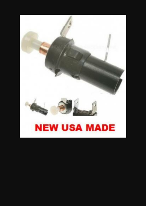

sounds a but easier. brake light switch is under the brake pedal right?
7,323
2,971
Brake light switch is above the brake pedal, bolted to the pedal bracket.
It will look similar to this. If.you have speed control, there will be 4 terminal but still look pretty much the same.

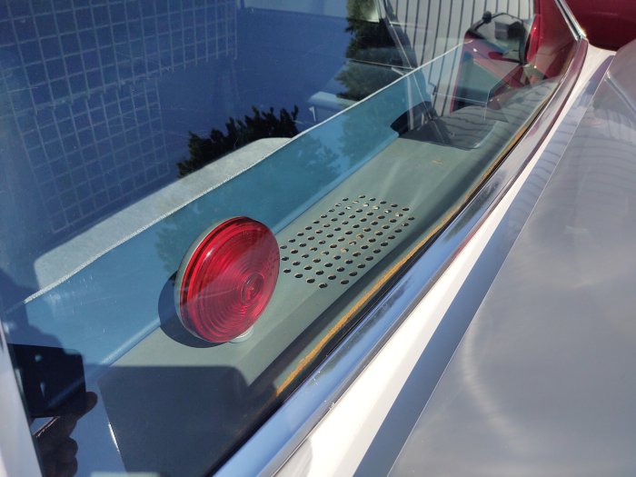

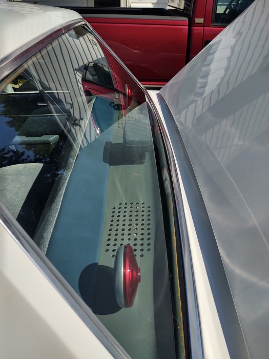

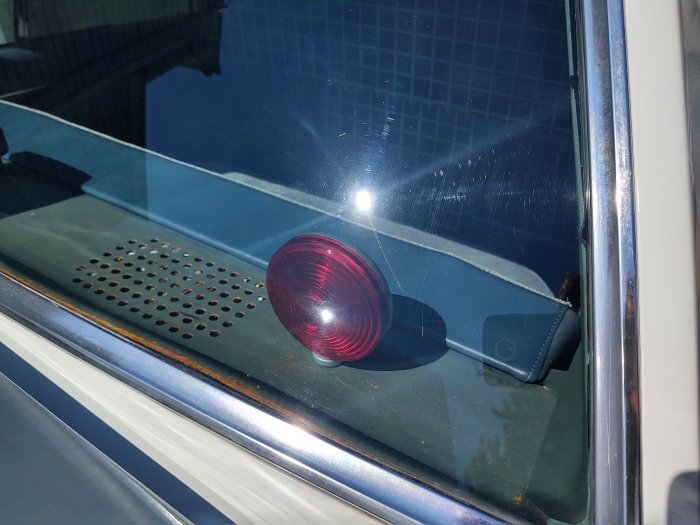

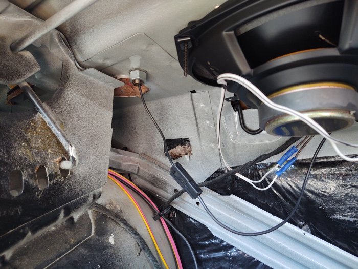

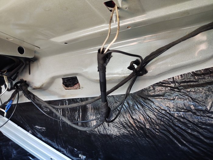

Live from NY... the 'lollipops' in the back were from various manufacturers. NYSP used Peterson PM334's, I've seen Dietz, Grote's from other agencies. These were typically only for the brakes (not turn signals) and were <crudely> tapped-into the rear harness with whatever wiring the outfitter had around. If installing for the first time there will be some measuring required, because of the rear speaker holes/remaining package tray area to drill through and mount.

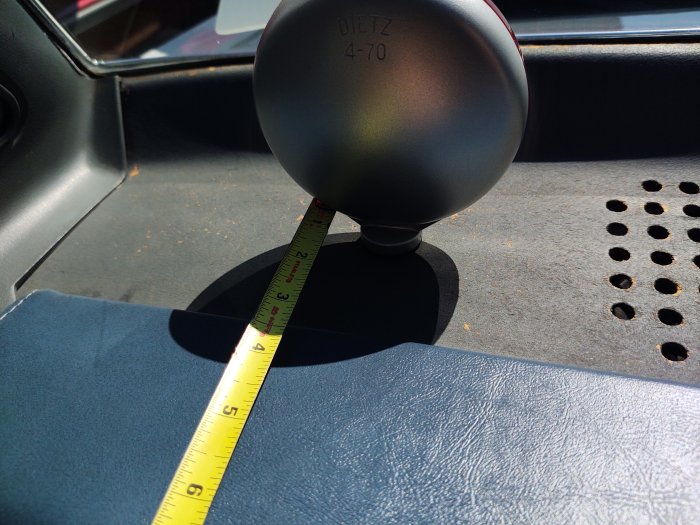

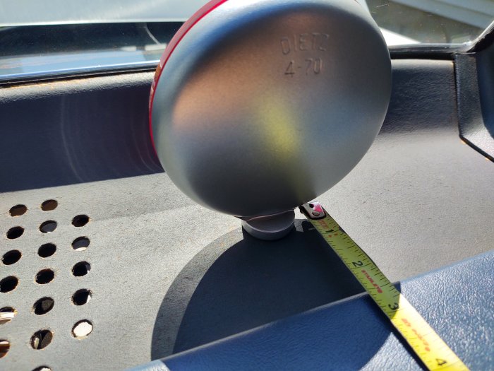

wolfmandip
Jan 1, 2013
32
23

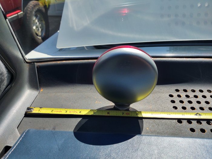

please note, reference measurements from parts that move/may be different on your car. even through the passenger side measures differently to the C pillar trim, both lights are centered on the car

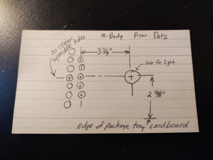

wolfmandip
Jan 1, 2013
32
23

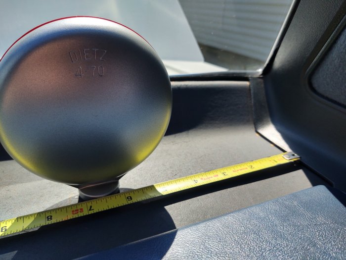

measurements I used to install. derived from numerous photos/reference materials. this is what I used for the images above, measure a bunch of times because the punched holes in the package tray are not parallel/possibly different on your application. The outfitters roughed these in, I probably over-thought the whole process

I have an image of the rear of the car to show how they look, will post once the camera battery charges up!

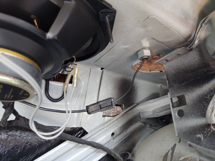

exactly what i needed! thank you so much. even the measurements! those black connectors are just an extension not a factory plug? then one black wire from each lollipop on either side goes into one of the two white wires to the third brake light? or both into one? appreciate it!
