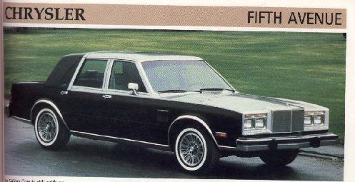

In addition to what's been said, The 1987 year had "both" Landau tops available:
the "short" top. on monochrome cars, most easily denoted by chrome around the top.
And the "long" top on the 2 tone cars, where the top comes down almost to the rear door handles, and the trim is painted body colour. All 5ths got long tops in 88&89.
