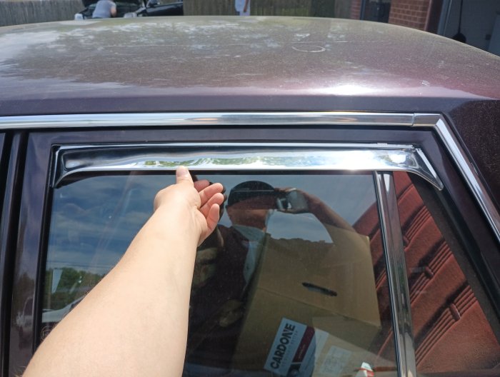

what number are the ones for 80-89 M's? got a pair of C-6's and i concur, the rear door ones do not fit. if anyone wants the rear door vents for their Aspen, you can have em
looks like in theory they should fit but the opera window is in the way. i've seen pictures of police cars with the whole rear window vent vs the Fifth's partial one. is there a spacer for the opera window's chrome piece?
My '82 Fifth Avenue had them, so yes they made a set that fit, is it the same as Fury/Diplomat I couldn't tell you
They're the same, they stop at that window channel.
The older ones like pictured looks like they're also too short. Maybe they could be made to fit by cutting a notch out of it to clear the channel and spread the ends out a bit?
