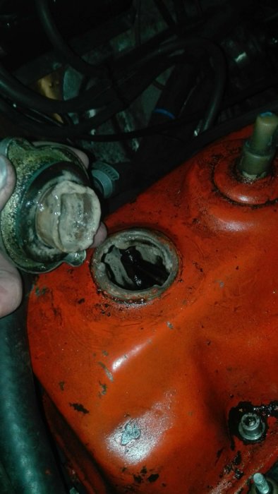

Dipstick showing water in oil 225
SixBanger
Jul 31, 2018
347
52
The Netherlands
Since short time, the dipstick and shows water in oil. So I have refreshed oil last week. Hoped it goes away. Oil was 10k+ old (mineral).
Headgasket replaced last Juni. (9k km ago)
No extensive oil consumption for this old fashion 225 slant hulk torque machine. Or and very slight coolant drop.
Re-tighten only head bolts?
SixBanger
Jul 31, 2018
347
52
The Netherlands
Re torqued the head bolts. All bolts doesn't need retorque. So maybe a leak path from coolant channel to pushrod galley, so head gasket gone? Gasket from Felpro.
Most drives are work-home 12 miles. But this weather could give more condense when cooling down.
7,323
2,971
It looks like condensation to me in the photo from what I can see. Going too long on oil changes, short trips of less than 10 miles, and cold weather make the condensation worse. Coolant in the oil is more yellowish looking where condensation is basically white. We see that at work all the time this time of year (October through April).
