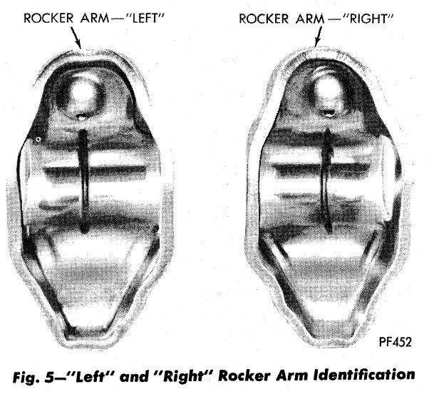

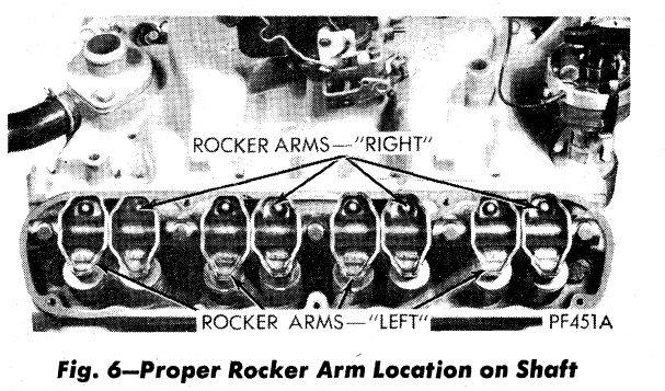

7. Small block rocker arms are pretty tough – but they do fail occasionally – in the location shown in your picture. There is a Left and a Right
Left 4448993 (MSRP is $25.16 (US) from Dodge)
Right 4448994 (MSRP is $24.99 (US) from Dodge)
Pushrod 4483721 (MSRP is $12.67 (US) from Dodge) – if you have roller lifters, which you should have.
Prices are as of today (May 2, 2017).

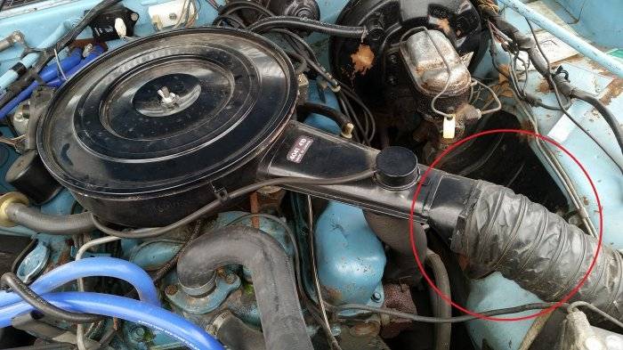

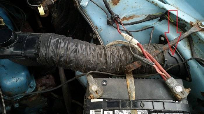

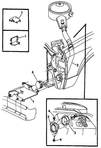

Have you ever rolled down the car window and stuck your hand out the window going highway speeds?
If you are not expecting it, it will toss your hand back.
Back in the mid ‘70’s, the factory’s figured out capturing that high pressure air, helps fuel mileage (about 1-2 MPG on highway) and helps with performance by using that high pressure cooler air (which is cooler than under-hood air).
For mostly city driving, you will not notice a thing. On the highway, you can tell the difference.
I would recommend replacing the chrome air cleaner with a factory style one, like pictured.
This one is a 2-bbl version. You would need a 4-bbl version.
I have a feeling the inner fender ductwork is still in place, by the battery (red arrow).

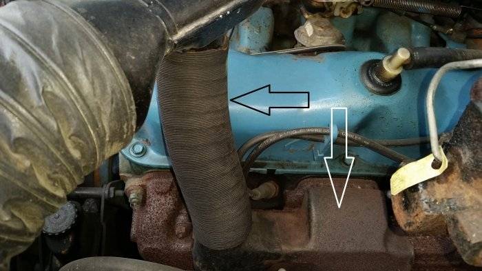

Item 2.
The white arrow is the heat stove and black arrow is paper/metal flex hose connecting air cleaner to stove.
If you live in mid Florida, you will not need either of these two items (unless you plan on driving North during winter time, for some reason).
