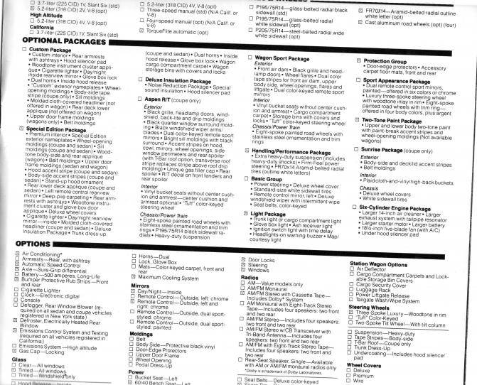

This weekends task was to make a plan for an imaginary client. I used myself as my own customer and made an order for 1980 Dodge Aspen sedan Special Edition with 5.9 liter 4BBL V8, TorqueFlite automatic. You can see all the things the customer wants in his car. You think these are still available with some luck and time?
If the pic is too small to see the crossed options, I list the things here separately: (Dont worry, I copied the option page, didn´t mess with a original one.)
-LA360 (I already have)
-TF727 lock-up that was used behind the 360 according to a website with Aspen/Volare history. (don´t have)
-Sure-grip differential: I have the 8.25 with sure-grip. I´d like the 11" drum brakes.
-Handling package: new shocks, torsion bars and leaf springs with their brackets and mounts. Also included the Firm-Feel power steering which I don´t know for sure how that separates from the original power steering?
-Full power range: brakes, seat and steering I have. Locks and windows not.
-AC: manual AC Ive got. would like to upgrade to SATC we´ve talk about so much. Maximum cooling system I don´t know what that is?
-Sport look aluminium wheels. Don´t have them either.
-AM/FM cassette stereo: I hope these are C-cassette players instead of 8-tracks.
-Three spoke wheel: I have tilt-column two spoke wheel, can I install 3- spoke into original steering column?
I think this would be a car for the fancy-pant, 50 year old man but I want to see the effort to get as exclusive Aspen there was at the date assembled.

Yeah, I´ll be one happy man after my car gets out of assembly line. However, some options didn´t open up to me. Why is maximum cooling wanted? Is it engin cooling or AC- cooling related?

I would say that the max cooling option would have to be engine cooling as there is really no difference in AC parts it either has AC or doesn't. However there are different size radiators. more rows, and wider for hot climates. being in Finland having a beefy radiator is probably not necessary. That would be an option for the deep south or the desert communities.
