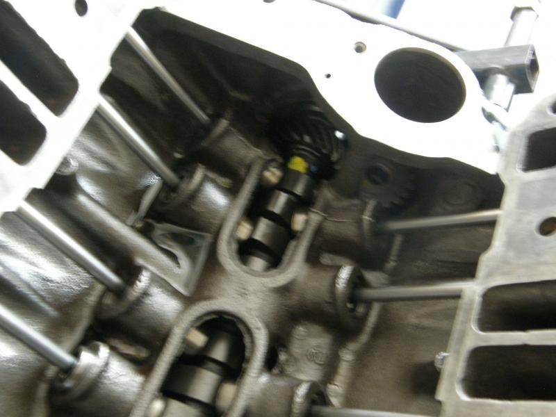

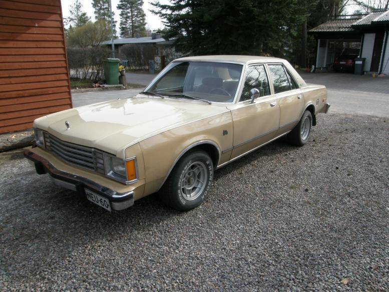

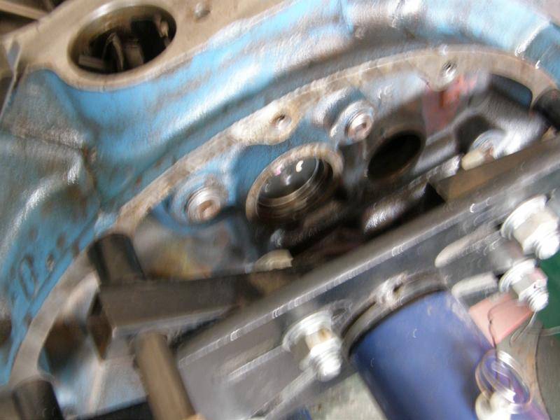

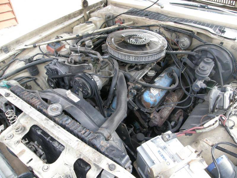

Hello again! After a brief "vacation" off my Aspen I´ve been finally getting time to take the 1st photos of the ride as well as few pics of the space I do my car in, and the current 360 engine, where I found that theres a small slice missing. There is, as always, a few questions as well.

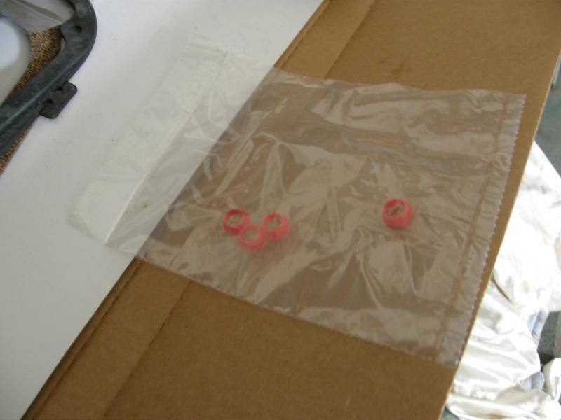

The red rubber rings, what are they for? Which plug do I need to install into camshaft end hole, the half- ball shaped one or flat one with a lip?
