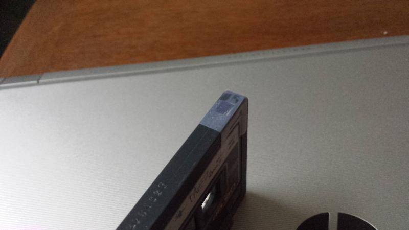

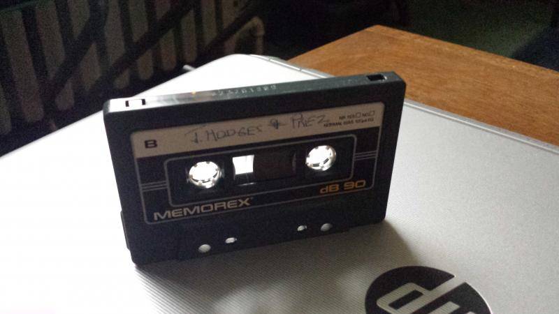

Off topic: does anyone remember C- cassettes? How does one record on a blank? I can´t depress the REC button on my blanks but I could overwrite on my flea market Iron Maiden album? When I try recording from a radio station, all I get is a woooosh sound on the cassette, even when they were playing music loud and clear... Damn you elder folk got it the hard way before all the internet downloading came along...

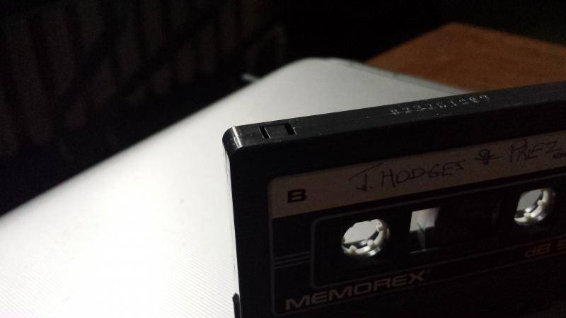

Here is your typical cassette.
The reason you can't depress the record button is because someone had knocked the plastic tab out to prevent erasure.
You'll see on the top one of the tabs is knocked out on this tape.
When you insert a cassette into a recorder a feeler like piece presses against that tab. If it's present it will allow the record button to be pressed, if it's missing it will not....the old trick is to put a piece of tape over the knocked out tab.....like so.

Got it, put some tape on them, working great now. I also found out that they still use some anti- recording distorter on our radio waves, thats why I can´t record off a radio...
