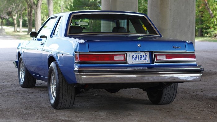

Unless you insist on having stock appearing exhaust tips, may I suggest the behind the wheel option?

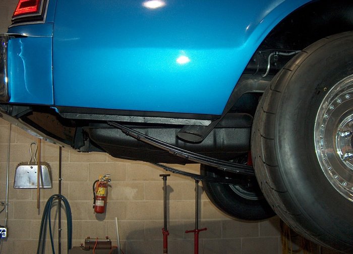

It was a ton of work doing my exhaust. Dual 2 1/2" pipes will fit going out the passenger side, JUST. There's about 1/8" tolerance or they'll hit the fuel tank, or spring shackle.

M_Body_Coupe - VERY NICE looking exhaust system. Where did you find the pipes? Mandrel bent stainless pipe is hard to find. Lyell's exhaust in Burlington, ON sells pieces for welding up. Here in NS nobody does mandrel bent exhaust pipe. :-( Did you find the interior exhaust noise increased with the 'behind the wheel' exit?
The exhaust was entirely done by a local race shop, so custom work all around.
Having said that, some of the piping did come out of a SummitRacing H-kit I picked up, thought it would have been an 'almost fit' on my coupe, but didn't like at all how ad-hoc the piping ended up once test-fitted. So I abandonded that approach, brought the car to the shop and had them do the work. Was very happy with the results.
Noise wise, what can I tell ya? The motor was already a hotter setup (238/244 @0.050 duration on 108LSA), so with headers and straight-through Hooker MaxFlow mufflers it's hard to talk about noise increase. Sure, it's louder, but that's "music to my ears" LOL

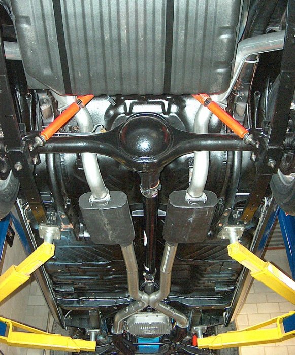

Aspen500,
Forgot to ask, what brand of muffler did you put on your car. BTW the underside of your car is pristine - well done!
Thank you!
At first it had Super Dynomax mufflers. Sounded nice but the interior drone was unbearable. Swapped to Dynomax Ultra Flo Welded mufflers. Drone is gone, but they are louder than I'd like. Added Vibrant Performance bottle style resonators behind the flex pipes up front. They toned down the high frequency notes but it's still loud.

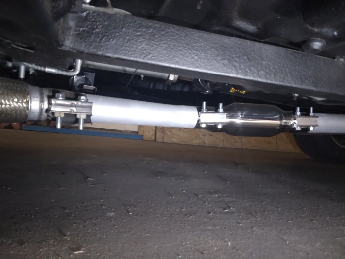

These are the resonators.
Aspen500.
Thanks for the follow-up. I'm curious as to why you added the flex pipes? I added a flex pipe to my Volvo 940 Turbo (2.3L 4 cyl. RWD, 3" downpipe and converter then 2.5" to a SS Magnaflow muffler at rear bumper), in an attempt to reduce drone which I assumed was from vibration. Didn't seem to make any difference. Planning to change the system to remove the flex pipe / cat and replace with a 3" Vibrant resonator. Will probably switch to stainless steel pipe as this vehicle is a year around DD.
Adding the flex pipes can help with exhaust clearance when you have a tight fit, allows the pipes to be more firmly mounted. For guys with headers, it usually help prevent cracking and collector gasket failure.
