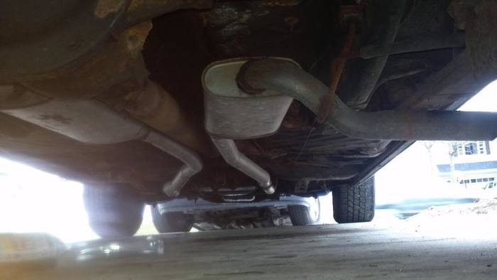

Here you go..chop the tips off and keep your single pipe in the back (disconnected)..they'll never know the difference.

Damnedest thing... they invented these things, they're called "saddle clamps". Next thing you know we'll have space travel! :icon_biggrin:
