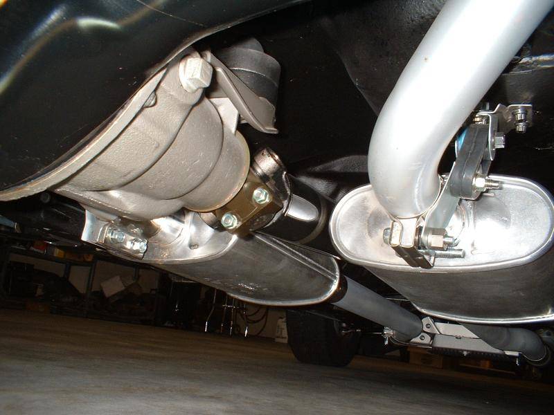

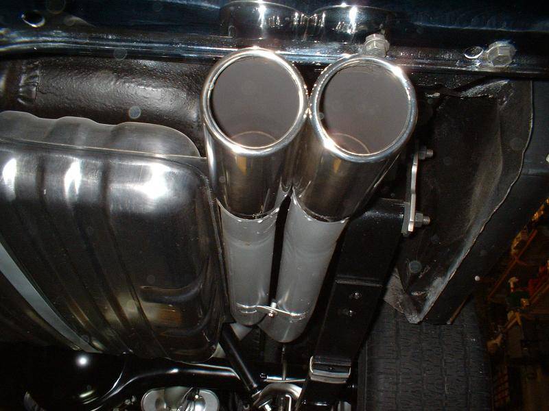

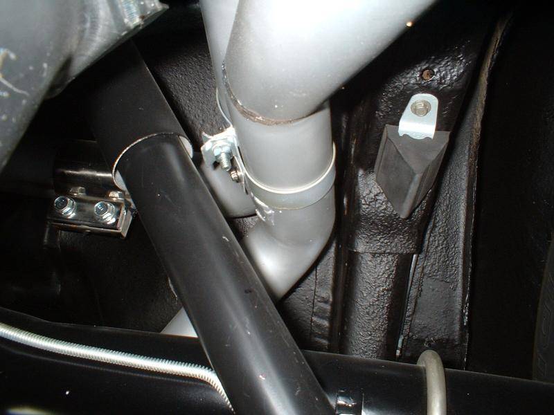

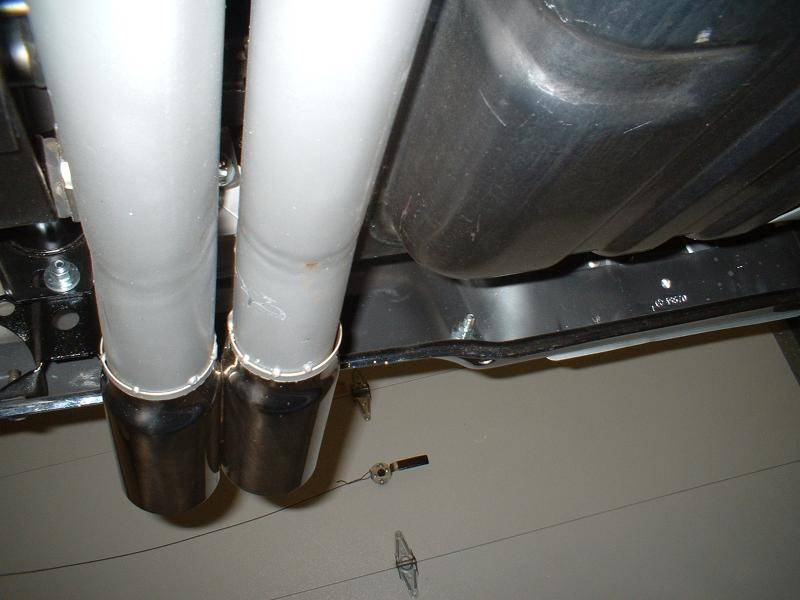

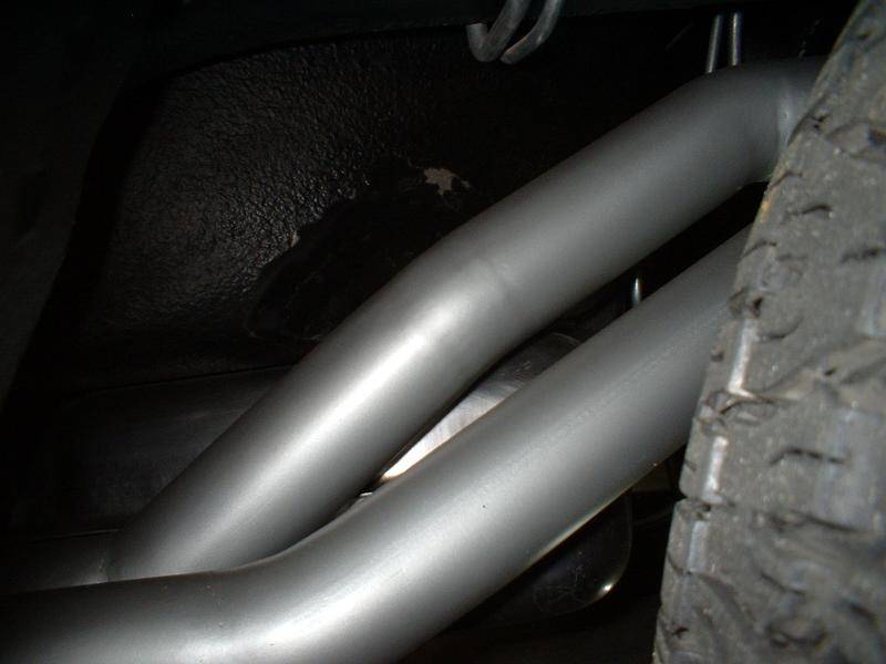

It is possible to run duals without moving the tank. It's a lot of work but 2 1/2" pipes will fit,,,,,,,,,,,,just. A 318 would get by fine with smaller pipe which would make thing a whole bunch easier.
I made my own exhaust using straight pipe and mandrel u-bends, cut and welded together. A decent place with a pipe bender (and a guy who knows what he's doing) can bend it up also. Only downside is, it'll most likely be compression bends and not mandrel.
Kind of hard to get good pics under the car but show what I mean.
