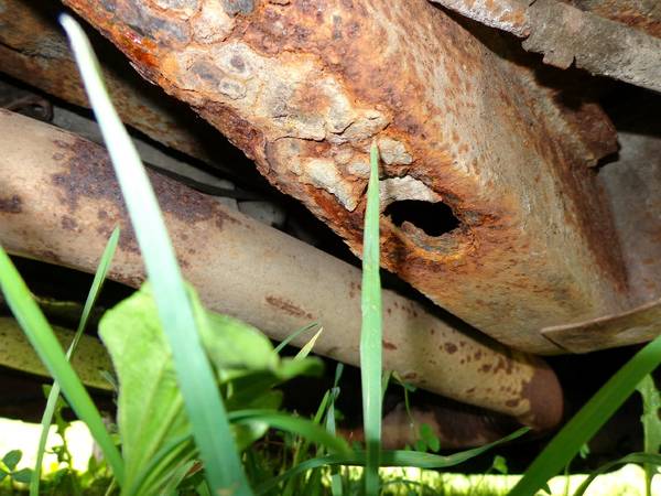

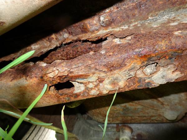

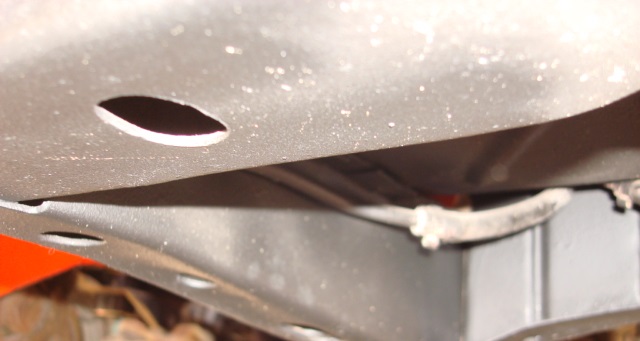

It seems to me it is more about the design of the front frames rails. Water sits in them after they get clogged with debris. I never noticed any difference in the replacement fenders vs the originals. The cowls drains also get clogged and hold water and over time rots is out. I don`t really know if anything was ever done( design wise) to fix those issues.
Front frame rails are the second thing I look at.
First is looking if I should even bother to look because I know the answer and it's bad.

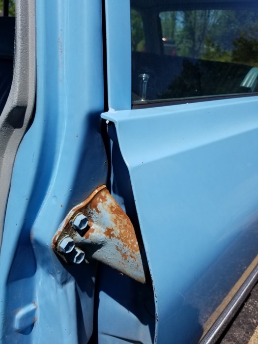

There are some areas on my ’77 wagon that really surprises me. This is the driver’s side rear door hinges. I thought I took a picture of both hinges, this afternoon, but it appears my shot was not centered.
Both hinges – the paint did not stick to them, due to items not being prepped before painting. I would suspect the hinges still had oil on them (possibly). The paint looks good on the B-pillar and hinge bolts, but not the hinges themselves.

As Bud W mentioned and posted, everything rusts. The pic of his hinge is a good example imo of a different grade metal and all got poor prep and poor paint because what was the life expectancy, service life of cars in the mid 70-s. Look at the meager warranty many cars got.

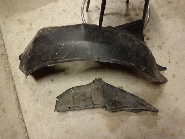

You can see in the pic here the pathetic early F inner liner vs the 78 up and the ones used, or what should of been used with the recall fenders.
Some also got the tiny lower plastic shield and if you look in the 77 parts book 12-100 12-2 12-3 they monkey around even on the splash shields on a couple dates before and after 9/76.
I love them, but what marble heads designed our cars?
Most think they were used later m-s and such but look at the older 368 part number prefix, go look at a org. 78 F or go look at your recall fenders.

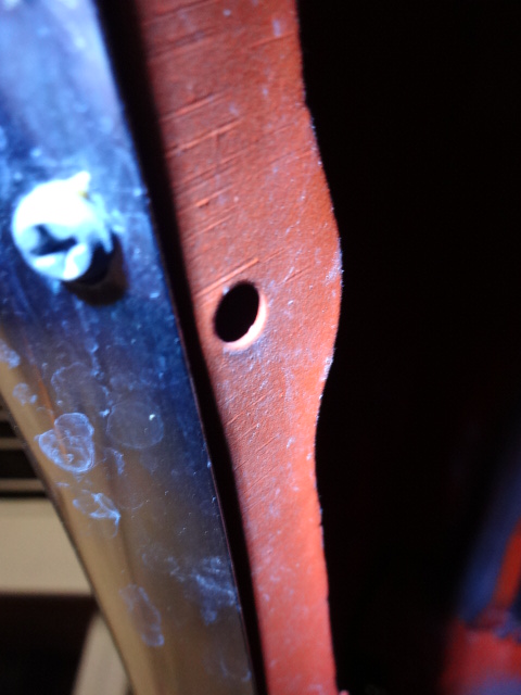

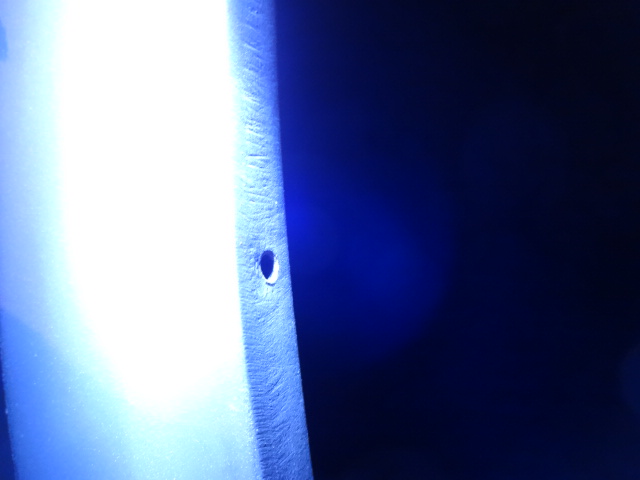

Here is the same spot on the drivers front fender, both 76 runners, one with org. fender showing only the hole for wheel molding if it was tagged for it and one with the recall /78 79 fender with the tab I posted about for the plastic liner. I dont drive this car so I never put the liners back in and to me they are just plain ugly like an afterthought.
But thats your visual difference in the recall vs non recall fenders, but im sure they might of even used left over 76-77 fenders and I still see the hard to find drivers 76 fender on ebay from time to time.

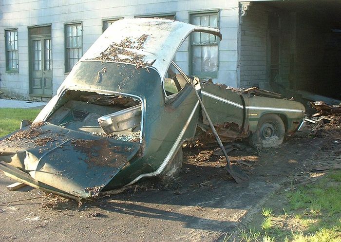

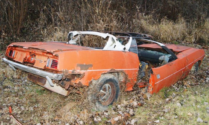

I always almost laugh when "they" say the Aspen/Volare were rust prone. They weren't any worse than other cars of the era. In high school (class of '82) I remember mid '70's Camaros, Mustangs, Cutlass, etc with the 1/4's flapping in the breeze, bottoms of the doors not attached to the inner panel, carpet hanging down from the gaping holes in the floors..................I guess we could put M50-15 tires on and save the money on air shocks because the wheel openings were missing enough sheet metal that they didn't rub so there is that advantage. Rust is an equal opportunity employer.

Anyway, that is why I thought it was worth it to go as far as the desert of Colorado to buy OY. No rust to speak of except for the same type of surface rust on the door hinges that Bud W. shows on his pic of his beautiful blue wagon above. Particularly 40+ years later, the F's don't stand out more than any other car regarding rust IMO.

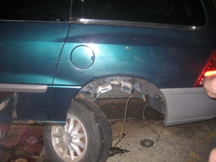

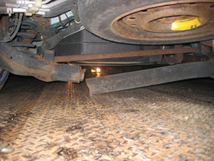

I've replaced more than one rear axle on Windstar/Freestar at work when they came in on the flat bed with about 10* negative camber in the rear, and those had the recall reenforcements installed. Rotted right in half. We replace front subframe (cradles) on Taurus's frequently. There's an outfit here that brings them in by the truck load from down south. Focus LOVES to have the front control arms literally rust in two and hopefully you aren't going very fast when they let go. Mentioned this on "the other site" I think, we see vehicles (usually pickups) with holes in the rockers, cab corners, above the rear wheels as new as 2014. Replaced a couple brake lines on a 2012 Malibu last week,,,,,,,,rusted through and leaking. For all the rust prevention measures they take, or don't take, seems vehicles rust out quicker than they have in 20 years. The joys of living in Wisconsin (or MN, MI, IL.................) A couple weeks ago, a 2011 F-150, went to lift it on the hoist, heard a crunching sound. Frame was collapsing where the hoist pad was, Sad. We've had people scrap not very old vehicles because of rust. One that comes to mind is a 2010 Toyota Tundra with under 50,000 miles. Frame so rotted the box and cab were jammed together,,,,,,,,,,and that was a couple years ago already. My favorite is when iron cylinder blocks, heads or exhaust manifolds rust through, not to mention steel oil pans. Even had a mid 2000's Silverado in last week with a leak. Was from the transfer case. It had a hole corroded through the aluminum. I guess it's all called, "job security".
