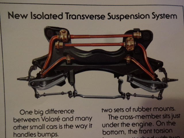

    Ya got two choices, well three, what the parts were appearance wise as produced which only some were painted, like the bare K and the way they dipped the t bars leaving parts still bare. I think a challenge today for example would be to copy a new made control arm look and how would you prep it to look "just produced" or what I recently did was detail it all in the more or less three color scheme as chrysler liked to portray it there literature and films.
    But back to the just produced look, since any media would be out of the question id look to some sort of rinse or dip to get them looking consistent back to bare then maybe hit with a protectant.
    Or like many new ones came, the thin rust proof undercarriage black they used on the power parts of the control arms. If you pull a unmolested k down you can tell easily what im referring to.
    Ive joked for years with some judges I know and there will never be a o.e. class for a f body so close would be good. UROE would of been cool if one had one clean enough but they wont ever do that either.
    I just recalled where I had seen pics of semi new F parts, some of the older chilton books have some real pics where chrysler books just had the diagrams.

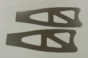

    For my current F & M cars, I hadn’t rebuilt the suspensions, yet – but on those, I will be installing these reinforcement plates to them:
    These are made by AR Engineering (part # AR053), but appear to only be available from Firm Feel (part # LCAP4).

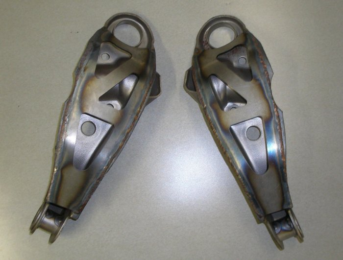

    This is a picture of Firm Feels lower arms after reinforcement plate is welded on (worms-eye view):

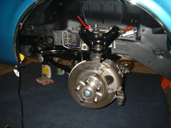

    Just don't go overboard like SOMEBODY did when they were building their car:confused:
    Pay no attention to the arrow, that was added to point out the recall plates for someone. DSCF0013.JPG

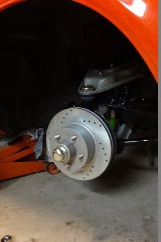

    I also like the painted way, this one I shot with etching primer (not rattle can) and used industrial oil based that I brushed on a light coat and then a heavy coat and then baked it a tiny bit.
    The last one I did I did the T bars in copper color, both sorta in the spirit of what the books and films and front end demo displays looked like long ago.
    I did use crapese rotors on the one here in the pic simply because I had them. Oem rotors suck semi bad as well.
    This one in the pic had very low miles as it was a drag car its first 1.5 years then parked, but it was uglier then Hillary and her Daughter combined. It didnt have cracks, it had sheared metal. One shock tower? Had a rip in it an inch and a half long, flippin crazy. So I replaced everything and welded the K itself in a few spots. I also put the FF lower plates on as it seemed like one of there products that actually made sense and was worth the money.
    Sorry its not a really good pic, my flash went out that day.

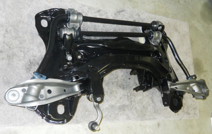

    well it took me a while as I am a slow azz but here is the pic of the K so far. btw, doing those torsion bars were a big pain. do not want to have to fool around with them again.
  14. XfbodyX
    XfbodyX Well-Known Member
    1,218
    241
    Sep 9, 2015
    Central US
    That looks really really nice, Ive a car just ready for it!
  15. volare 77
    volare 77 Well-Known Member
    1,352
    178
    Jun 12, 2014
    maryland
    also, ceramic cast iron spray was darn close to bare metal in color. at least its close enough to satisfy me

    X body , thanks still have a ways to go. got to clean up the upper suspension now.

    I thought you posted about wanting oem, thats far far nicer?
    Even though I blast and etch prime my K-s and then hose them with industrial black they look oem rough up close.
    If you dont mind posting it, what did you pay for the powder coating of the K?
  18. volare 77
    1,352
    178
    Jun 12, 2014
    maryland
    $200, turned out nice. he really got the inner crevices clean. honestly I was hesitant to pay for the powder coating as i like to try and do stuff myself. I`m happy I did now. Seems to be pretty durable so far. I brought it to him stripped. He had to do minor clean up. It would have been $50 to $75 more if he had to blast it.
