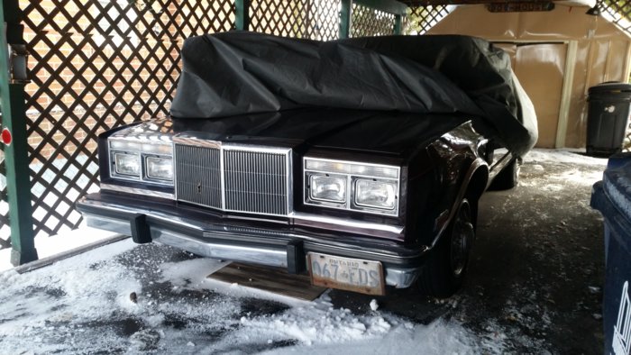

Pic is Feb 12th. Oldstart/Coldstart since early October! lol

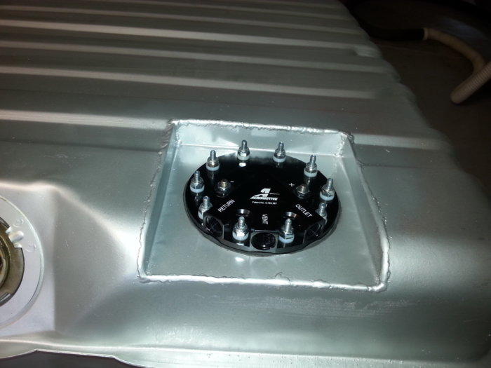

My plan is to obtain a pair of new fuel tanks (start fresh – a new tank per car) and install something like this into both tanks:
This is an add-in in-tank fuel pump with its own “well” so car won’t run out of fuel under high G-forces – which I subject my cars to, often.

If your tanks need to be replaced anyway (leaks or rust) that is a good way to go.
If not, FiTech also makes something called a Fuel Commander. it is added on after the mechanical fuel pump, and takes the fuel pressure from 5-7 lbs. to 63 lbs. needed by their fuel injection systems. It also has a well/reservoir that helps with the fuel sloshing problem. I on't personally happen to think that it is as good as the Aeromotive set up shown above, but it is something to consider for anybody who has an existing fuel system that is in good shape. I think the Fuel Commander is cheaper, and it is a much simpler way to go.
