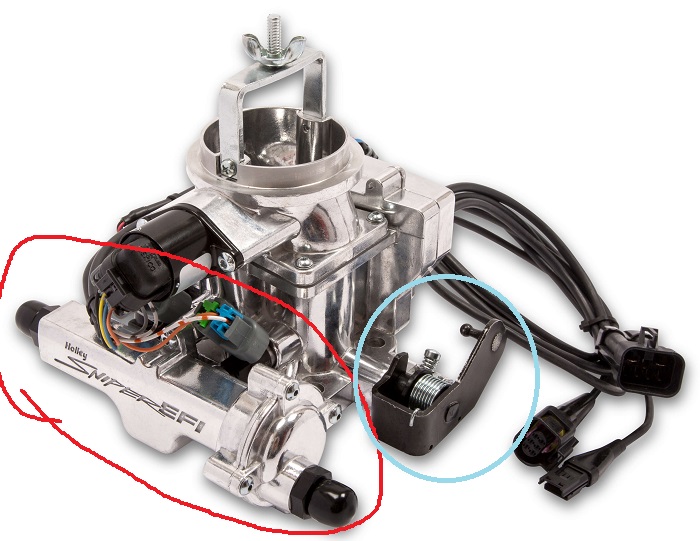

Holley has a Jeep BBD replacement system Sniper EFI BBD for Jeep CJ - Holley Performance Products but there is this weird attachment (red circle - pressure regulator?) in front that appears it might interfere with a 318 (possibly). Also, the throttle linkage is wrong (blue circle).

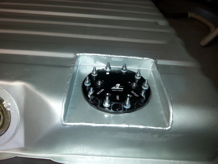

To change subject a bit, when I was looking at FI setups, I decided to go with this style fuel pump with modified new fuel tanks. Not a fan of welding used fuel tanks plus the fact there is no telling how much rust (or other crud) is inside of a 40-year old tank. New fuel tanks (mid-year 79 to ’89) are the same.

In post #41 there is a picture of a modified fuel tank. I'm curious about what application that tank is for.
It is from an "unknown" Chrysler product which I copied from them to apply for my own needs.
I don't remember from which For_BodiesOnly site it was from.
