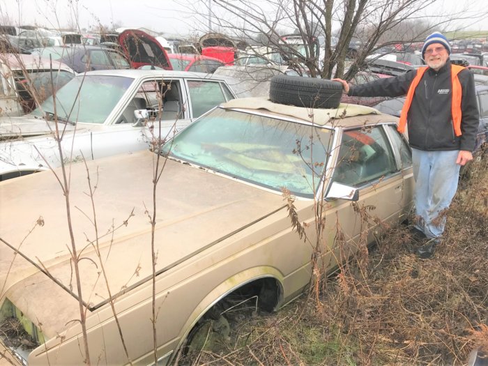

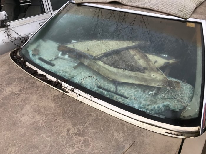

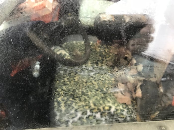

When I converted an 81 I had years ago I used every thing off a 318 Mirada and the factory dash still worked in the Imp when I was done, just not the MPG functions on the dash keyboard! There was a special piece on the intake to make all that work in the factory conversion. the speedo has its own electronic conversion module on the left side of the fire wall by the master cylinder. It changes the cabel input to electronic input and should still work either way! Visited this 81 yesterday in a local yard, dig that leopard print on the seats and dash! We got the sun roof mechs out of it last year and the cabal is now functioning in mine!

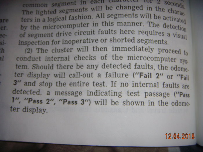

This is all I've got for you at the moment. From the factory books:
Hope it helps.

Many thanks, Poly
But most of the problem is due to the fact that the FI is gone along with many of the related sensors etc.
When I get a chance I'll post a picture of the cute little bundle of wires that is taped to the firewall that was all connected to the factory system.
