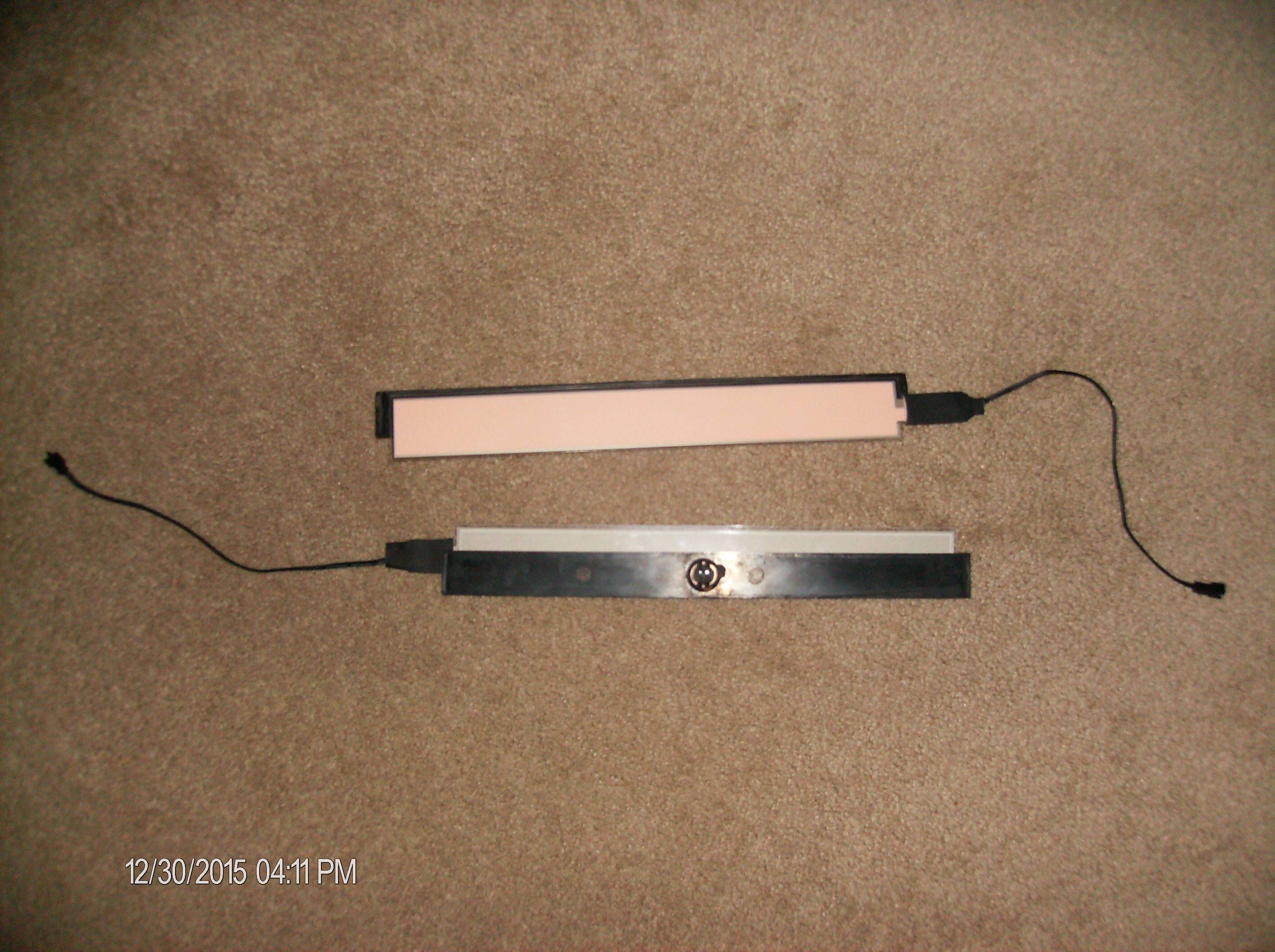

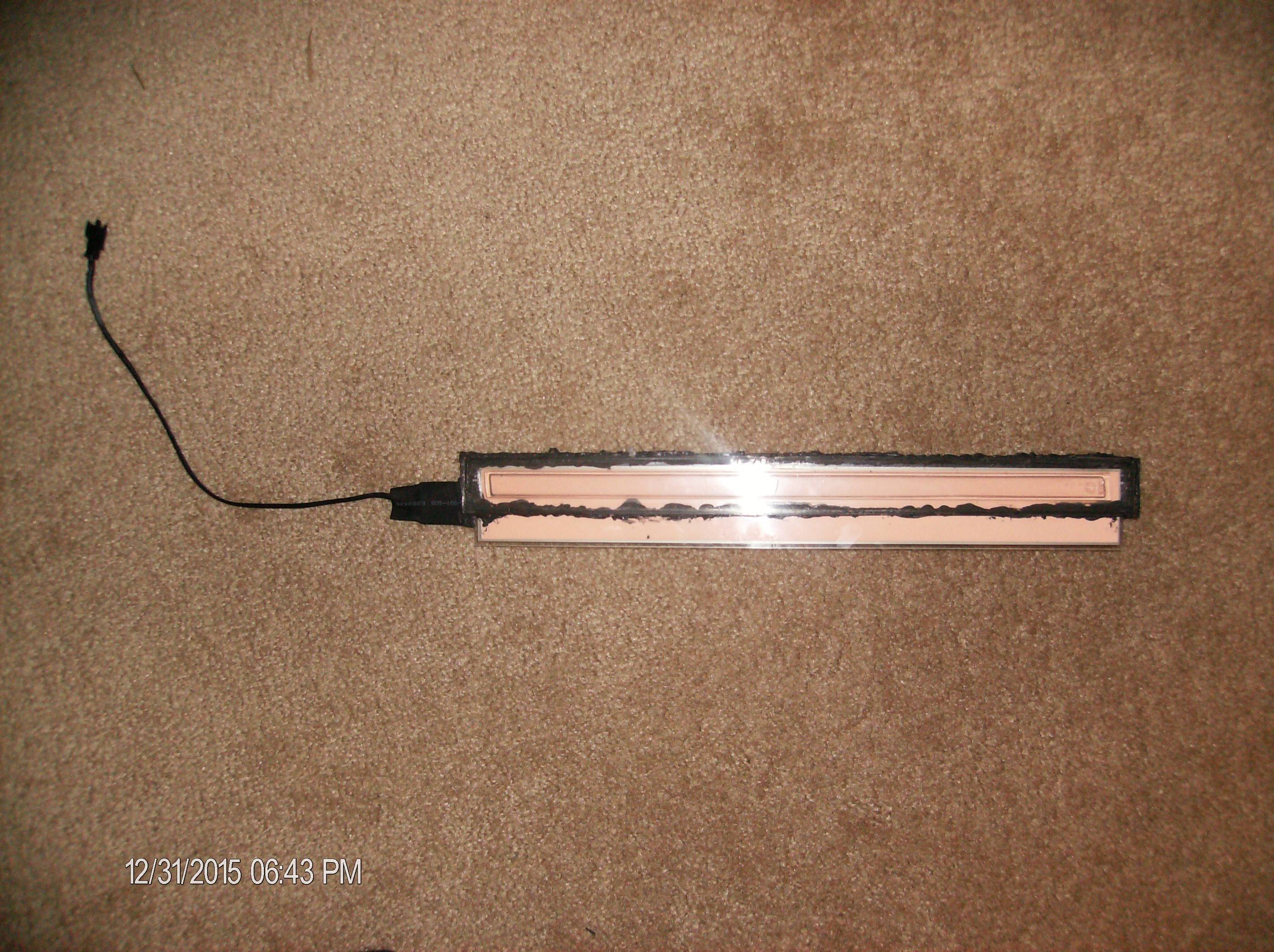

As requested, here's some pics of my repair with the 12 inch by 1.25 inch strips that I got from glowhut.
As mentioned, glowhut said NOT to cut the strips, so I had to trim the black backing plate to permit the side on the strip to hang outside. I then RTV'd the clear lense over the strip to ensure a seal and prevent fogging.
In the pics you'll see how the strip I got was too wide for the backing plate. Next pic shows the RTV mess, and the last step shows them working on my car!
Thanks to everyone who has posted on how to do this repair!
