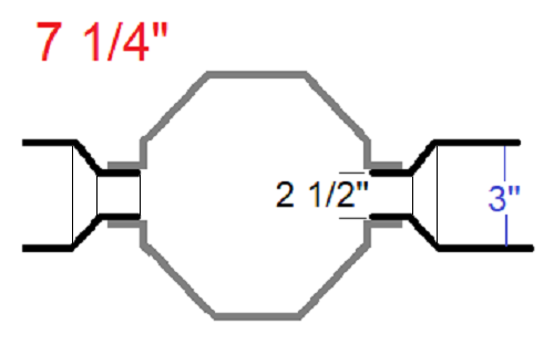

    Yes, Chrysler did make available a limited slip for 7¼”, for many years as an option and as a dealer installed upgrade. Parts are out there but I hadn’t seen one for sale in some time.
    All FMJ differentials will fully interchange – with one exception.
    The early F & M bodies with 7¼” had 2½” diameter tubes the entire distance and their ISO-clamps had different spacing because of the tube diameter. In the late ‘70’s, the 7¼” tube diameter got increased to 3” so ISO-clamps interchange – but the tube tapered down to 2½” just before it went into the center housing.
    To me, looking for this taper is a quick way to tell if you have an FMJ 7¼” (which the tube taper only exists for FMJ 7¼” – and no other Chrysler product has it).
