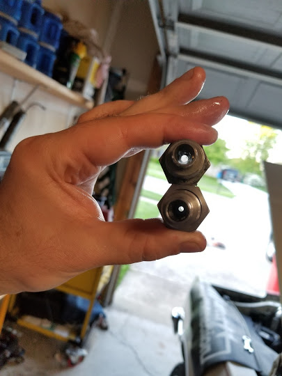

so finally got the steering done and no longer leaking. ended up just using some reman parts from rock and napa, things haven't been going as planned this year to do much better. I did try the suggestion in the article "pumping it down" that Duke5A posted and it does seem to have some better steering feel. i'm sure if I had been able to use steer and gear or firm feel it would be better but I will take what I can. now just got to straighten out the wheel and one less project to do on it
1,834
1,040
That's good to hear. How many shims did you end up installing?
The Saginaw pumps are actually GM units and were used in so many different models of cars and trucks. Every model had different requirements for flow (GPM) and pressure (PSI). The parts store rebuilds never gave much of a care as to what valving were used in their builds and sold them without that in mind. You never know what you're getting with a parts store build. They may have pulled a valve from the pile for a GM 2500 truck and stuck in a pump for an M body Chrysler. So you never know what you're starting with.
The shims drop the pressure, but there are fittings that also reduce the flow. I had messed around with both until I had it to where I was happy, and of course the pump started leaking out the front seal. After three parts store pumps over the last couple years all started leaking out the front seal I eventually just ordered a unit from the same place I got my box; which was Borgeson. Of course, from them it came valved to match their box.

surprisingly there were not in it to start. I started with the shim thickness they suggest to start with which is .062. pretty sure the rebuilder had the wrong adaptor on the back since the new hose wouldn't seal with it. its good enough for now, at least I can drive it without leaving a puddle or going thru a quart of fluid every couple days.
