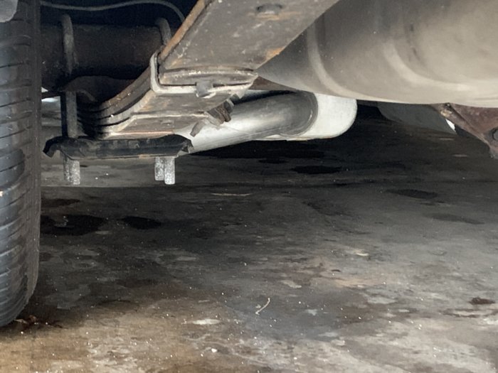

Camtron do you have any pictures of the set up installed?
@picklesgarage, for me, it’s just their FMJ bottom plate and Ubolts. The kit comes with sway bar brackets too but, I haven’t got a rear sway bar.
1,494
If you need to replace the rear shocks – I would use the FFI B-body ISO-Delete kit over the FFI FMJ ISO-Delete kit. The money to FFI is the same and a few more options with B-body shocks over FMJ shocks.
The FMJ shock plate is still in use and can barely be seen in the above picture. It is sandwiched between the differential perch and leaf spring.
I really dislike working on FMJ lower shock studs (a huge pain in da ___) so ditching the rear (lower) stud is a big plus. Also, if a person plans on using air shocks or spring-assisted rear shocks – I don’t think the (original) FMJ shock plate will hold up long term (or even short term) – but that is my opinion only. Leaving the FMJ shock plate in place looks goofy and over complicated vs. the older shock plate (or FFI’s B-body ISO-Delete kit).
