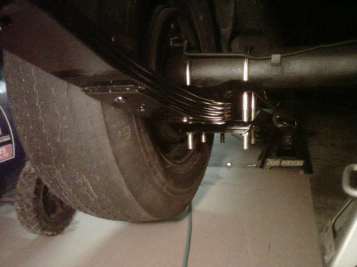

For our cars they offer the aluminum pucks to replace the 4 rubber ones that are sandwich in between the k member and the frame...they also offer a package called the rear isolation delete kit...which removes the rubber that is sandwiched in between the leaf spring...I got both of those kits for my car because I was tired of the swaying boat ride on the freeway...can't wait to drive it again I have the rear done and can't wait to do the front...they offer poly bushing sets and more...

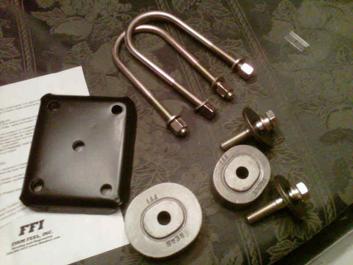

I got their rear leaf spring hangers for use with E-body XHD springs.Vey pleased with results, and the guys at Firm Feel were very helpful on the phone.

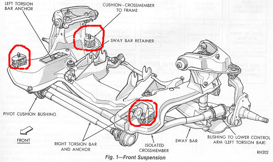

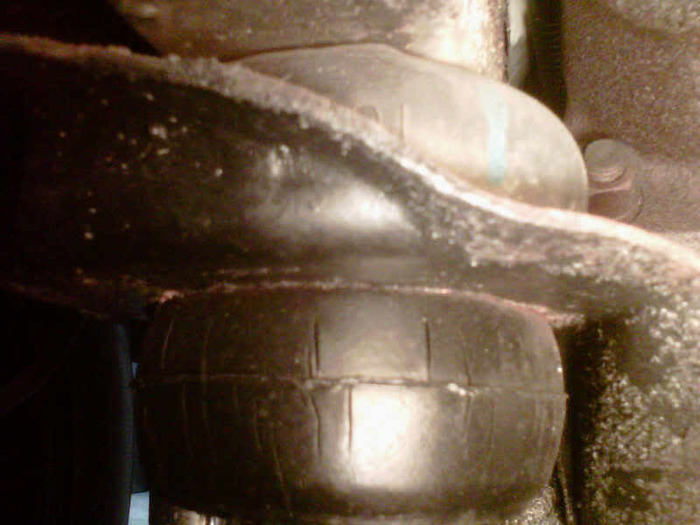

I like the idea that they've done the K-frame isolators. No more scouring the junk yards looking for cast iron ones.
Eric, you mentioned in another thread about the boat ride and trying to eliminate it.
When the old rubbers get like the ones on yours, it gets even worse.

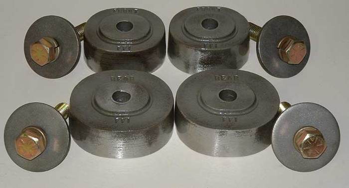

Here's a better pic of the bottom plate and u-bolts I have one of the top spacer and stud when I find it I will add it...
old tired rebel
Mar 1, 2011
196
1
Looks like it a little smaller than mine. I will takes some pictures and post them.

Cool thats what I thought. What about leaf springs? A or B body? I'm thinkin B.
res1vw21
Feb 26, 2011
153
2
near seattle
The new front hangers are set up to take your standard E body springs though you could probably use your super stock ones.

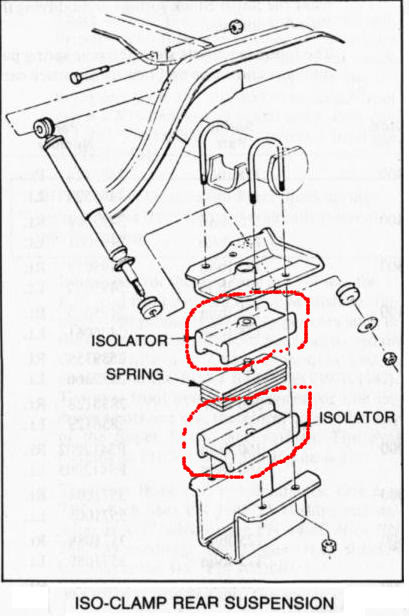

where does your shock bolt to?
If you look at the pick in post #10, the shock bolts to the upper plate thats between the axle housing and the leaf spring. The shock has a stud as the bottom point of attachment and eyelet at the top. Post #1 has an exploded view diagram of this.
