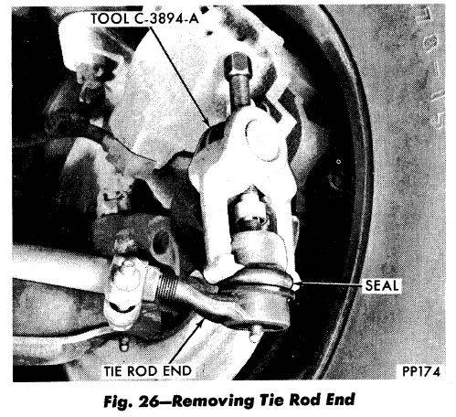

And tie rod separator.
A pickle form (ball joint/tie rod separator) will work in a pinch – but were not designed to work on Mopar's. My experience is they will tear up the boot each and every time they are tried. If you are not planning on reusing the joints/tie rods, then go for it

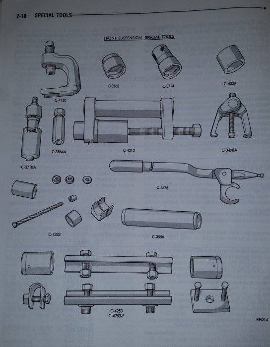

Edit: there is a list of the official Chrysler tools - but I would recommend getting the cheaper (and more effective) tools from parts store or tool store.

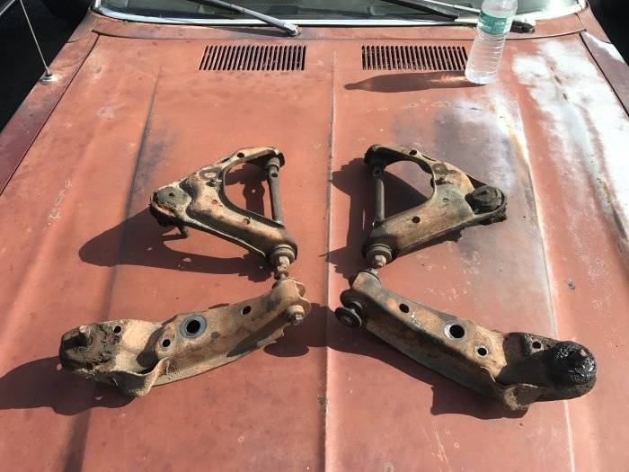

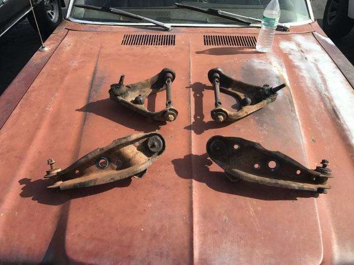

So I went to the pick a part, and pulled the lowers off of a 79 /6 Aspen. I used a sledge hammer and fork as I'm not interested in saving the ball joints. It was a pain to say the least. Mostly rust welded bolts that didn't want to give. I bent up a number of wrenches and stripped a couple of sockets. I nearly walked away from the whole ordeal. After a couple hours of persistence though, I got em off. Looking forward to sending them off to Firm Feel to have them bead blasted, straightened, reinforced, and powder coated.

Went ahead and pulled the uppers to. Talked to firm feel yesterday, i wouldn't be able to use my Moog bushings with their tubular uca's. Probably just going to have a local shop sand blast and powder coat all four. I got a friend that's a front end guy, think he has all the tools for the bushings and ball joints.

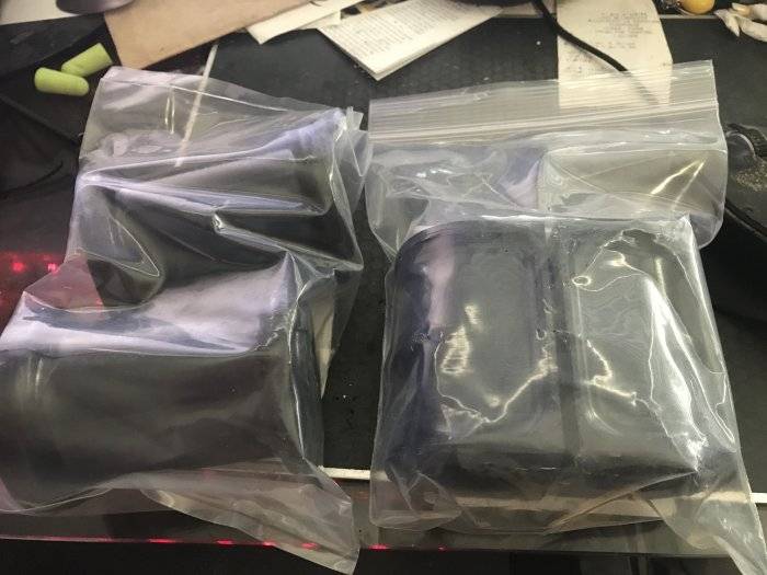

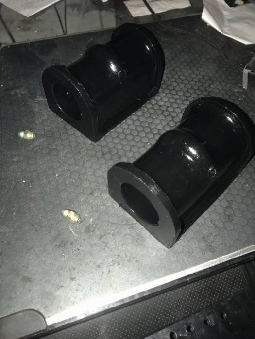

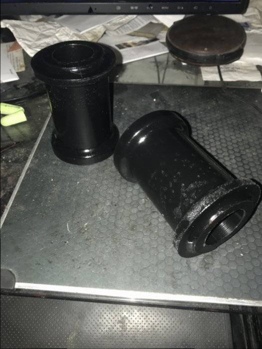

I got a buddy that was a front end guy for many years, says he's even worked on Volares. Hes a longshoreman mechanic today in Long Beach Harbor. He says he can break it loose on the bench with an impact gun and the mopar socket, once its loose you can turn it out with a pair of channel locks he says. Going to find out this weekend. Oh and look what I got in the mail today....
Rare Parts torsion bar bushings. Got the mount to frame bushings (RP18551) for $127.00, including taxes and shipping, off of carpartsdiscount.com. The isolator bushings (RP15653) I got from Jegs for $138.00 with free shipping. Wish I could have got the ones with the metal, but those seem to be an endangered species. I'm happy though, that now I can rehab the torsion bars too.

About five years ago, the torsion bar bushings/mounts were everywhere. In last two years, they flat disappeared (a mini black hole appeared?). I should have invested in a bunch of them five years ago . . .
I would like to see a picture of your T/B bushings out of their bags, if I could.
